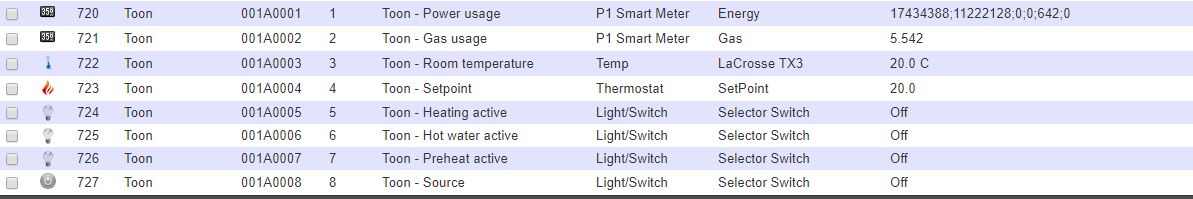

Attie
- Posts: 5
- Joined: Tuesday 02 May 2017 21:25
Re: Error ToonThermostat
After updating to the latest Beta I've got rit of the "failed to load 'plugin.py'" error and became a lot further.
Here is the log:
2019-02-23 10:02:49.316 Status: (Toon) Started.
2019-02-23 10:02:51.314 Status: (Toon) Entering work loop.
2019-02-23 10:02:51.315 Status: (Toon) Initialized version 1.0.0, author 'John van de Vrugt'
2019-02-23 10:02:51.519 Error: (Toon) 'onStart' failed 'NameError'.
2019-02-23 10:02:51.519 Error: (Toon) ----> Line 141 in '/home/pi/domoticz/plugins/toonapilib4domoticz/plugin.py', function onStart
2019-02-23 10:02:51.519 Error: (Toon) ----> Line 35 in '/home/pi/domoticz/plugins/toonapilib4domoticz/plugin.py', function onStart
2019-02-23 10:02:51.519 Error: (Toon) ----> Line 101 in '/usr/local/lib/python3.5/dist-packages/toonapilib/toonapilib.py', function __init__
2019-02-23 10:02:51.519 Error: (Toon) ----> Line 145 in '/usr/local/lib/python3.5/dist-packages/toonapilib/toonapilib.py', function _authenticate
2019-02-23 10:02:51.519 Error: (Toon) ----> Line 122 in '/usr/local/lib/python3.5/dist-packages/toonapilib/toonapilib.py', function _get_challenge_code
2019-02-23 10:02:51.519 Error: (Toon) ----> Line 258 in '/usr/local/lib/python3.5/dist-packages/toonapilib/toonapilib.py', function _patched_request
2019-02-23 10:02:51.519 Error: (Toon) ----> Line 892 in '/usr/local/lib/python3.5/dist-packages/requests/models.py', function json
2019-02-23 10:02:51.519 Error: (Toon) ----> Line 516 in '/usr/lib/python3/dist-packages/simplejson/__init__.py', function loads
2019-02-23 10:02:51.519 Error: (Toon) ----> Line 374 in '/usr/lib/python3/dist-packages/simplejson/decoder.py', function decode
2019-02-23 10:02:51.519 Error: (Toon) ----> Line 404 in '/usr/lib/python3/dist-packages/simplejson/decoder.py', function raw_decode
2019-02-23 10:02:51.519 Error: (Toon) ----> Line 33 in '/usr/lib/python3/dist-packages/simplejson/scanner.py', function __init__
No devices found ...
UPDATE!!!
I saw there is a update on de plugin.py and I uploaded to the dir and now it works!
I see the toon devices in the list. Good work!

waspy
- Posts: 52
- Joined: Friday 22 February 2019 0:00
- Domoticz version: 4.10430
Riny,rinyheuvelman wrote: Saturday 23 February 2019 4:26 2019-02-23 04:10:23.669 Status: (Toon) Entering work loop.
2019-02-23 04:10:23.670 Status: (Toon) Initialized version 1.0.0, author 'John van de Vrugt'
followed by:
2019-02-23 04:22:26.420 Error: (Toon) 'onHeartbeat' failed 'KeyError'.
2019-02-23 04:22:26.420 Error: (Toon) ----> Line 169 in '/home/pi/domoticz/plugins/toonapilib4domoticz/plugin.py', function onHeartbeat
2019-02-23 04:22:26.420 Error: (Toon) ----> Line 94 in '/home/pi/domoticz/plugins/toonapilib4domoticz/plugin.py', function onHeartbeat
2019-02-23 04:22:26.420 Error: (Toon) ----> Line 101 in '/home/pi/domoticz/plugins/toonapilib4domoticz/plugin.py', function UpdateDevices
No devices added at all...?
Did you use an unique hardware name?
On start the plugin reads the number of devices that belong to the hardware.
If none, it will add all the devices that belong to the hardware/plugin.
Else it starts updating its devices.
From your log file I think that it somehow detects devices, but then during update it is missing devices that should have been created earlier.
My advise: a clean start
1. Delete the plugin in the hardware page.
2. Stop the domoticz service (sudo service domoticz stop).
3. Remove the plugin from the domoticz plugin folder, e.g. cd /home/pi/dev-domoticz/plugins/; sudo rm -rf toonapilib4domoticz.
4. Double check if you removed the toonapilib4domoticz plugin.
5. clone the toonapilib from git again. (I just updated the script) cd /home/pi/dev-domoticz/plugins; git clone https://github.com/JohnvandeVrugt/toona ... moticz.git
6. Restart the domoticz service
7. Select the toonapilib hardware.
8. Use an unique hardware name.
9. Double check your credentials.
10. Press Add/Toevoegen
Check the log for errors / check if any devices are created.
Just followed the steps myself without any issues.
Good luck!

- a3vd
- Posts: 22
- Joined: Tuesday 25 February 2014 14:02
- Location: Noordwijk, The Netherlands
Yes it's working again will look in to the scripts later to make the light switch working again but this is great !
Big thanks to John (y)
Yes! It's working after I've update Domoticz to the betaversion.
Some small issue:
- On top of the gas and elektra graphs, the buttons "back" and "report" are missing.
Some small issue:

- Posts: 994
@waspy : Thanks for this solution
I'm only using just two settings of Toon: Setpoint and Room temperature. If I just remove the other devices will they be added again if check for new hardware? Or have I to strip unused devices from the python script?
Can I remove Toon - Source also? It's not clear to me what it does.
Thanks for your help.
