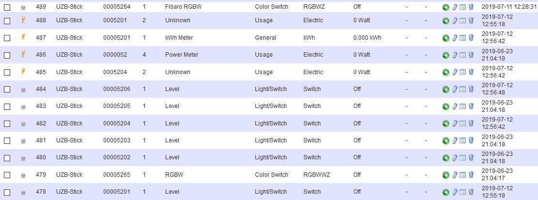

Thanks for the groundwork. I had the same problem with the configuration. To activate the 4 inputs I used the value -65534 + 34952 = -30582, which was also accepted by the device. So far OK.
Unfortunately I don't see the 4 expected 0-10V sensors in the device list, only switches.
What has to be considered?
Thank you in advance...

Find below corresponding screen shots
