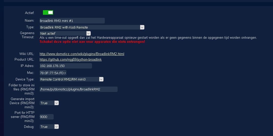

I have installed the latest version of Domoticz V4.10436 on my Raspberry.
Today I have done the installation steps for my Broadlink RM3 following all steps of the wiki.
THe HW and the Broadlink devices are visible.
However I get errors, not able to find my RM#:

Hw definition in Domoticz
HW Broadlink.JPG (54.88 KiB) Viewed 1920 times

put your MAC addres in this format :
2017-03-26 18:33:39.278 (My br) Device 1 MAC address = b3330ddd260b
kollemt

Ok
Thanks. The layout issue of the MAC address did indeed solve the problem of the connection.
