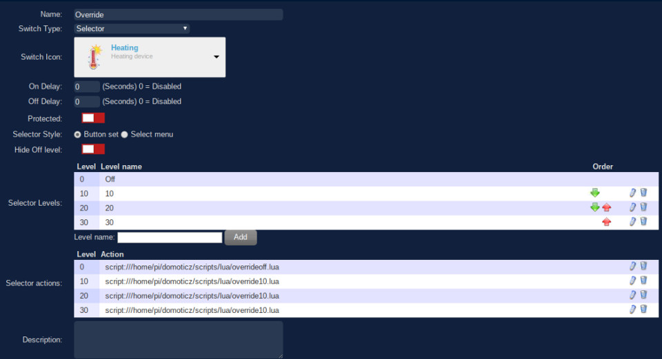

I've created four copies of this script and called them overrideoff.lua override10.lua override20.lua and override30.lua and tweaked them to print 'hello world 10' etc. Any of them runs correctly when it's renamed to the correct device script. I've then deleted script_device_override.lua and set them up in the selector like this:
Now, on pressing a button, I get a pop-up 'switching 30' (or whichever button I pressed) message, the log says
2019-02-18 16:54:55.872 Status: User: username initiated a switch command (60/Override/Set Level)
2019-02-18 16:54:56.081 Status: Executing script: /home/pi/domoticz/scripts/lua/override30.lua
but no 'hello world' appears.
What I'm trying to get across is that the scripts all work correctly when set up as device scripts, but not when called - in the same folder - from the selector. I'm sure I'm doing something obviously wrong but, having read the events section of the wiki as you suggest (and many other pages besides), I can't see what I need to do to make this work.

Just remove those entries in the Device screen for Selector Actions, as the script_device_override.lua script will run each time the Override device changes. Then in the script you can do something like this:
command Array = {}
print ('hello world... Device Override was fired and option '.. otherdevices_svalues['Override'] .. ' was selected')
if otherdevices_svalues['Override'] == "0" then
   print("---  do whatever 0 needs to do")
elseif otherdevices_svalues['Override'] == "10" then
   print("---  do whatever 10 needs to do")
elseif otherdevices_svalues['Override'] == "20" then
   print("---  do whatever 20 needs to do")
elseif otherdevices_svalues['Override'] == "30" then
   print("---  do whatever 30 needs to do")
return commandArray
You only need to use the Selector Actions ( or Switch Actions for switch devices) when you want to run an script outside of the Event subsystem.

Many, MANY thanks. It was the reading of the selector value into the script that had eluded me.
All working and understood... now the fun really begins!
