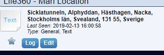

Minglarn
Posts: 214
Domoticz version: v3.8153
Location: Stockholm / Sweden
Re: Python Plugin: Life 360 Presence Detection
Post by Minglarn »
Hi!
Love the plugin... However... my phyton knowlege is kinda zero..
How do I trunc the text to just contain the first sentence before the first "," ...
I just want the "Sicklatunneln" ... the rest is just to much info :)
febalci
Posts: 331
Joined: Monday 03 July 2017 19:58
Post by febalci »
Minglarn wrote: Wednesday 13 February 2019 16:05 Hi!
Looks easy. Open the plugin.py in a text editor go to:
Line 212:
Under
currentstat2, currentloc = a.getaddress(self.tomtomapikey,self.circleLatitude,self.circleLongitude)
add:
currentloc = currentloc.split(',',1)[0]
and the same on line 217. This assumes all your addresses are in the format like xxxx, xxxx, xxxx, xxxx and so theis command gets the first text before the first comma. Also these added lines should start on the same column with their previus lines and you should go there by pressing space bar, not tab... Like:
                            if self.tomtomapikey != 'Empty':
                                currentstat, currentmin = a.getdistance(self.tomtomapikey,self.circleLatitude,self.circleLongitude,self.myHomelat,self.myHomelon)

Minglarn
Posts: 214
Post by Minglarn »
Great work!
Really, really liked the location.txt file ... Suits my dash panel PERFECT!
