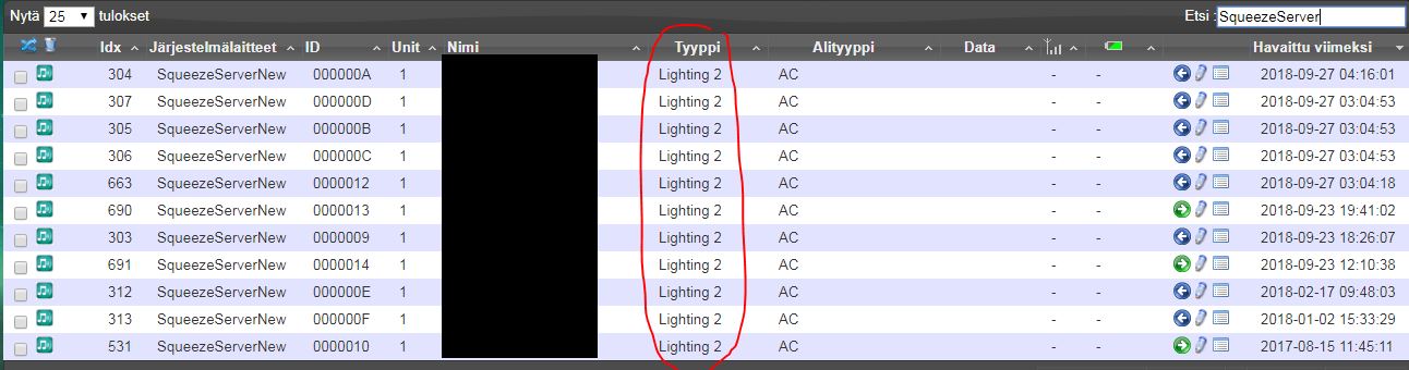

If you look at the devices table, can you see any switches under the LMS hardware? Anything strange with those?
Does it look similar?

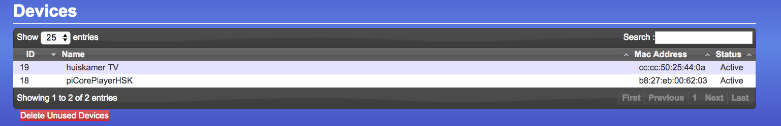

Nope, no switches at all.
But on the hardware tab:
Screen Shot 2018-10-01 at 11.01.48.png (61.41 KiB) Viewed 3897 times
This is all.
