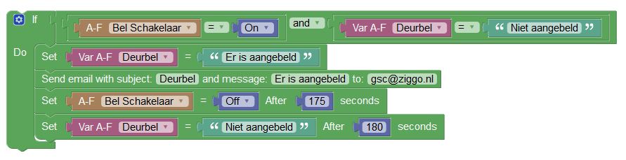

But to use in blocky a user variable I need to create it first before I can add it as a block is it?
gschmidt
- Posts: 200
- Joined: Thursday 20 December 2018 11:03
Re: Doorbell script question
I have created a User Variable Deurbel ["Niet aangebeld","Er is aangebeld"] in **/#/UserVariables (see picture)
And a blockly script as you suggested (blockly picture)
Although de "Deurbel Schakelaar" is set to ON, the script is not activated (according to the Log)
What I don't understand is how does the blockly script knows that "var Deurbel" is default set to "Niet Aangebeld"?
I just typed the text "Niet Aangebeld" en "Er is aangebeld" in a text field....???
- User_Variable.JPG (16.73 KiB) Viewed 2701 times
- Blockly.JPG (44.76 KiB) Viewed 2701 times
gschmidt
- Posts: 200
Hmmm think I figured it out...I first have to set "var Deurbel".
So I added it to the blockly script that triggers "Bel Schakelaar"
This appears to work
But isn't there a way to set "var Deurbel" to "Niet aangebeld" by default?
- Blockly Deurbel.JPG (21.67 KiB) Viewed 2699 times

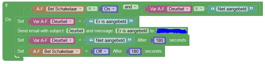

Of course you'll have to do that, else the if condition won't be true. Where you can create the variables you can also give it a certain value 'Niet aangebeld' in this case.
The time after which the switch has to go off again has to be shorter than the time for the variable, else the condition might be true again because of a small overlap.
I didn't know the 'Bel Schakelaar' didn't go to 'Off' after being pressed... You can also set an Off delay on the switch itself so it'll go off automatically after switched on.
If [ [ [Bel Schakelaar] = [On] ] and [ [var Deurbel] = ["Niet aangebeld"] ] ]
Do [Set [var Deurbel] = ["Er is aangebeld"] ]
[Send email]
[Set [Bel Schakelaar] = [Off] after [3] seconds]
[Set [var Deurbel] = ["Niet aangebeld"] after [10] seconds]

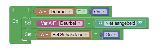

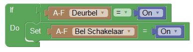

I think I confused you a bit:
I have a doorbell learned in domoticz as (Deurbel). This showed not up as an ON/OFF switch but is shown in domoticz as when the bell button at the frontdoor is pressed 1 time, domoticz log shows in a very short time 3 x a notification (sometimes 4 or 5):
Now I could add a (e-mail) notification to Deurbel, but I don't want >3 notifications.
So as a workaround I created a dummy ON/OFF switch "Bel Schakelaar". And use the "Bel Schakelaar" for the notifications.
In blockly I created a 1st script which sets "Bel Schakelaar" to ON when Deurbel is pressed at the frontdoor.
But this blockly script is also triggered 3 times, although "Bel Schakelaar" is already set to ON
So I understand your suggestion to add a variable. This is the script you suggested:
But this script is not triggered, and I have created a variable "Deurbel" with value "Niet aangebeld"
So I really don't know what I am missing here??
2019-02-10 11:44:04.926 (RFXtrx433XL) Lighting 4 (Deurbel)
2019-02-10 11:44:04.935 (RFXtrx433XL) Lighting 4 (Deurbel)
2019-02-10 11:44:04.949 (RFXtrx433XL) Lighting 4 (Deurbel)
tozzke
- Posts: 135
- Joined: Friday 02 January 2015 9:22
- Domoticz version: Stable
And this script won't trigger because you're using the wrong If-blockly... If you're only using 1 If statement, you'll have to use the If-blockly WITHOUT the blue gear icon on the top leftgschmidt wrote: Sunday 10 February 2019 12:54 I think I confused you a bit:
Now I could add a (e-mail) notification to Deurbel, but I don't want >3 notifications.Code: Select all
2019-02-10 11:44:04.926 (RFXtrx433XL) Lighting 4 (Deurbel) 2019-02-10 11:44:04.935 (RFXtrx433XL) Lighting 4 (Deurbel) 2019-02-10 11:44:04.949 (RFXtrx433XL) Lighting 4 (Deurbel)
gschmidt
- Posts: 200
Yep...I also figured out...I modified a script and forgot to change
Now its working, Thanx man!
