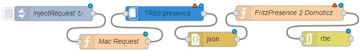

based on the great work in gathering the presence from the fritzBox using the ARP/DHCP lease tabel for devices, I used to do the same but using nodered. her eis the flow:
[{"id":"e4fbaee1.690b3","type":"tab","label":"Flow 1","disabled":false,"info":""},{"id":"252c212b.e222be","type":"inject","z":"e4fbaee1.690b3","name":"injectRequest","topic":"","payload":"[{\"NewMACAddress\":\"94:FE:22:F2:D1:A2\"},{\"NewMACAddress\":\"40:9C:28:2D:BC:A3\"}]","payloadType":"json","repeat":"600","crontab":"","once":false,"onceDelay":0.1,"x":132,"y":77,"wires":[["de401f57.eb358"]]},{"id":"5b0bc536.5d486c","type":"fritzbox-in","z":"e4fbaee1.690b3","device":"","name":"TR69.presence","service":"urn:dslforum-org:service:Hosts:1","action":"GetSpecificHostEntry","arguments":"{\"NewMACAddress\":\"value\"}","x":359,"y":77,"wires":[["6764a833.1f81a8"]]},{"id":"6764a833.1f81a8","type":"json","z":"e4fbaee1.690b3","name":"","property":"payload","action":"obj","pretty":false,"x":457,"y":130,"wires":[["9a04354d.3c8888"]]},{"id":"9a04354d.3c8888","type":"function","z":"e4fbaee1.690b3","name":"FritzPresence 2 Domoticz","func":"var preMsg = {};\npreMsg.payload = {};\n\nvar preMap = {\n '<hostName as it appears in fritz>' : {\"command\": \"switchlight\", \"idx\": <DomoticzIdx>, \"switchcmd\": setOnOff(parseInt(msg.payload.NewActive),false) },\n};\n\nreturn {\"topic\": msg.payload.NewHostName , \"payload\": preMap[msg.payload.NewHostName]};\n\n\nfunction setOnOff(curValue, invert) {\n switch (curValue) {\n case 0:\n if (invert === false) {\n return \"Off\"\n } else {\n return \"On\";\n }\n break;\n case 1:\n if (invert === false) {\n return \"On\"\n } else {\n return \"Off\";\n }\n break;\n }\n}","outputs":1,"noerr":4,"x":615,"y":76,"wires":[["efa0aa25.90f2e8"]]},{"id":"efa0aa25.90f2e8","type":"rbe","z":"e4fbaee1.690b3","name":"","func":"rbe","gap":"","start":"","inout":"out","property":"payload","x":690,"y":129,"wires":[[]]},{"id":"de401f57.eb358","type":"function","z":"e4fbaee1.690b3","name":"Mac Request","func":"return [[\n { \"payload\" : {\n \"NewMACAddress\": \"AA:BB:CC:DD:EE:FF\"\n }\n },\n { \"payload\" : {\n \"NewMACAddress\": \"FF:AA:BB:CC:DD:EE\"\n }\n }\n]];","outputs":1,"noerr":0,"x":255,"y":135,"wires":[["5b0bc536.5d486c"]]}]
the flow inject a request every 10 minutes to the mac request node that contain the mac address to request, the messages goes to the Fritz.In node that returns a message for each device with the status.
Status goes to the FritzPresence 2 Domoticz that decode the hostname to a MQTT telegram with the correct IDX, a RBE node prevent multiple messages with the same payload.

the only requirement is node-red-contrib-fritz
Nodes Condifuration:
MAC request
this is used to list the Mac address you want to retrieve
return [[
    { "payload" : {
        "NewMACAddress": "AA:BB:CC:DD:EE:FF"
    { "payload" : {
        "NewMACAddress": "FF:EE:DD:CC:BB:AA"
add as many as you need
The Fritz TR node needs to be configured with the oruter address, user and pass
this is used to parse the hostname to the virtual switch IDX in domoticz:
var preMap = {
    'hostname' : {"command": "switchlight", "idx": IDX, "switchcmd": setOnOff(parseInt(msg.payload.NewActive),false) }
you have to replace hostname with the name as shown in the fritz LAN host view
then you have to replace the IDX with the device IDX avaliable in the device table view in domoticz
