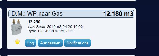

I use a script to divide the Heatpump Kwh meter to 2Kwh to 1M3 gas.
And this Kwh meter is set to a dummy gas.:
DZ vents script Khw to Gas:
on = { timer = { "every 1 minutes"}}, --at 21:52 every minute
execute = function(dz)
local WarmtepompKWH = dz.devices('Z: WP Tot').counterToday
dz.log(WarmtepompKWH)
local WP_gas = dz.devices('D.M.: WP naar Gas')
local usage = WarmtepompKWH * 500
dz.log(usage)
WP_gas.updateGas(usage)
dz.openURL('http://192.168.5.70:8080/json.htm?type=command&param=udevice&idx=12268&nvalue=0&svalue='..usage)
So i get a dummy filled with "gas":
Only i mis the total counter.. this counter that is in this meter is only a day total counter.
And this total counter [ a Always total counter not for 1 day ] is needed for a good upload tot mindergas
