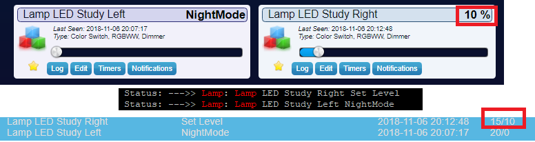

@Egregius, could it be this code has a 'bug'' ?
Pretty much interested in this bit:
As this if statement is false all the time: if(apcu_fetch($name)!=$level)
$level is a number I would like the dimmer to go to and the apcu_fetch($name) response in my case says "Set Level". hence not the same. And will never be the same. Am I missing a crucial piece of information here
I was building a dimmer function so it would go slowly up or down to a specific level and my debug log showed the 'Set Level' all the time in stead of the value of the dimmed lamp.
function sl($name,$level,$check=false){
global $user;
$idx=idx($name);
lg(' (SETLEVEL) | '.$user.' => '.$name.' '.$level);
if($idx>0){
if($check==false)file_get_contents('http://[::1]:8080/json.htm?type=command¶m=switchlight&idx='.$idx.'&switchcmd=Set%20Level&level='.$level);
else{
if(apcu_fetch($name)!=$level)file_get_contents('http://[::1]:8080/json.htm?type=command¶m=switchlight&idx='.$idx.'&switchcmd=Set%20Level&level='.$level);
}else{
apcu_store($name,$level);
apcu_store('T'.$name,time());
}Code: Select all

apcu_fetch($name) should return a number.
Can you check the Current State in domoticz (in the events window)?
Did you add the name of the dimmer to the array in the pass2php file?
elseif(in_array($device,array('eettafel','zithoek','kamer','tobi','alex','Xvol','Rliving','Rbureel','RkeukenL','RkeukenR','RkamerL','RkamerR','Rtobi','Ralex','luifel'))){
if($status=='Off'||$status=='Open'){
apcu_store($device,0);
}elseif($status=='On'||$status=='Closed'){
apcu_store($device,100);
}else{
$status=filter_var($status,FILTER_SANITIZE_NUMBER_INT);
apcu_store($device,$status);
}- sincze
- Posts: 1302
- Domoticz version: 2024.4
Re: Pass2PHP
Did you add the name of the dimmer to the array in the pass2php file?Egregius wrote: Tuesday 06 November 2018 12:15 apcu_fetch($name) should return a number.
Did you add the name of the dimmer to the array in the pass2php file?Code: Select all
elseif(in_array($device,array('eettafel','zithoek','kamer','tobi','alex','Xvol','Rliving','Rbureel','RkeukenL','RkeukenR','RkamerL','RkamerR','Rtobi','Ralex','luifel'))){ if($status=='Off'||$status=='Open'){ apcu_store($device,0); }elseif($status=='On'||$status=='Closed'){ apcu_store($device,100); }else{ $status=filter_var($status,FILTER_SANITIZE_NUMBER_INT); apcu_store($device,$status); } }
- Damn... missed that one.. That is why I received the wrong result..
