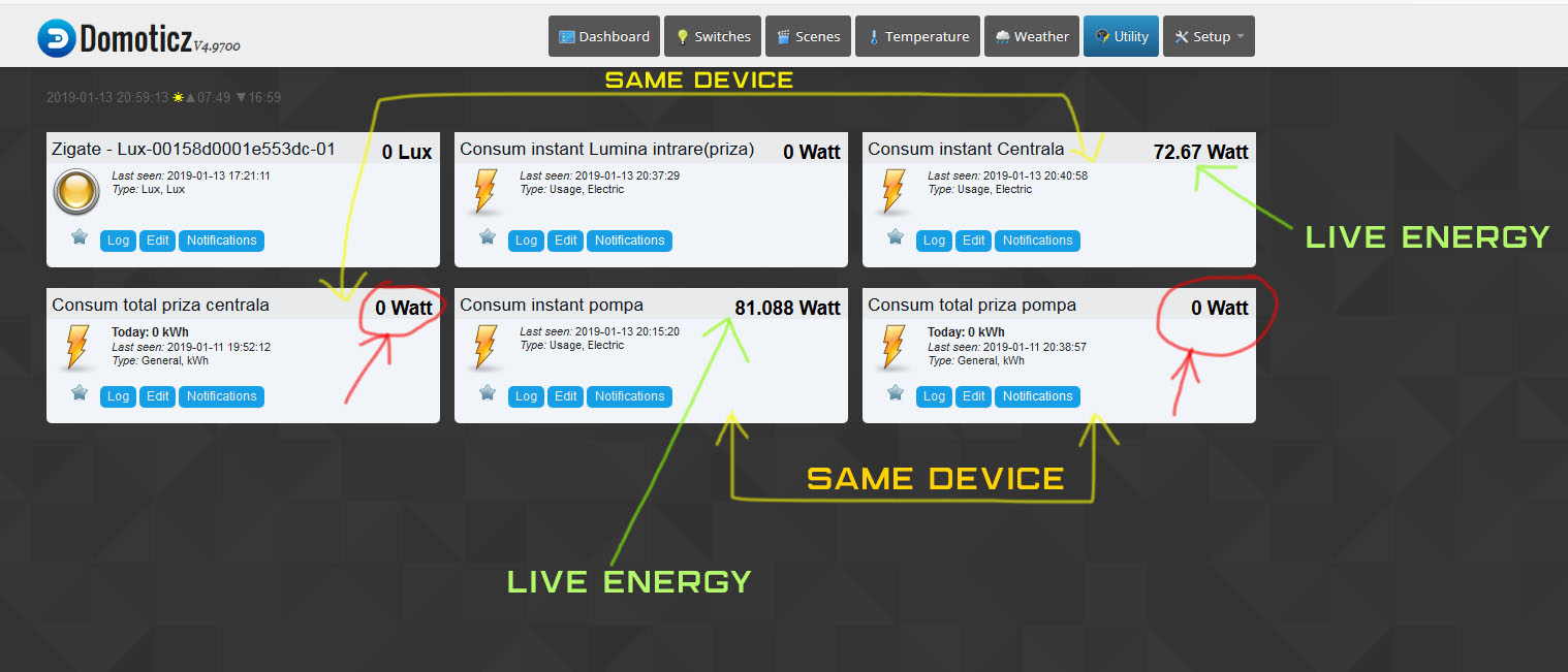

Live energy it's working on Xiaomi smart socket...but do not working Energy Counter...it is remain 0 KW.
In attached image Counter is with red circle, same device with yellow and live energy with green

Re: Not working Energy counter for Xiaomi smart socket on Zigate
Could you please provide the plugin version you are using ?
I'll have a look this evening at home where I have a Salus plug and a Xiaomi smartplug and are working correctly.
@pfloryann , thanks a lot for reporting that issue.
I've created an issue on Github https://github.com/sasu-drooz/Domoticz- ... issues/322
And it is now fixed.
If you update the plugin to Version 4.0.7 it should be back to normal
Just let me know
Just let me know

Yes is working now after plugin update. Thank you!
