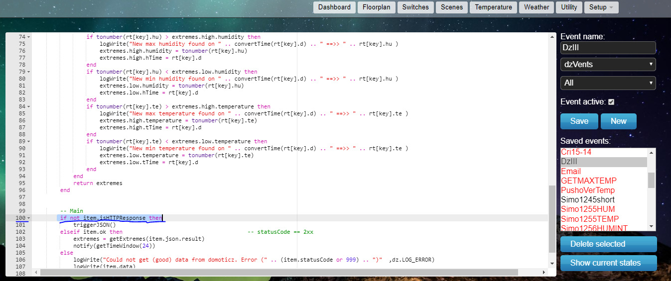

I have saved and Enabled the script but at 11:20 I haven't seen any info about temp or humidity... the log only shows
EventSystem: reset all events...
EventSystem: Write file: /home/ubuntu/domoticz/scripts/dzVents/generated_scripts/GETMAXTEMP.lua

When I execute the script I receive a notification on pushover and see the following in the domoticz log:
2019-01-18 21:31:01.580  Status: dzVents: !Info:
Extremes between Friday, 18 January 2019 (21:31) and Thursday, 17 January 2019 (21:31)
high Temperature: 4.3 Celsius at Friday, 18 January 2019 (15:00)
low temperature: -3.5 Celsius at Friday, 18 January 2019 (07:00)
high humidity: 100% at Friday, 18 January 2019 (07:00)
low humidity:  74% at Friday, 18 January 2019 (16:00)
2019-01-18 21:31:01.602  Status: Notification: Extremes between Friday, 18 January 2019 (21:31) and Thursday, 17 January 2019 (21:31)
2019-01-18 21:31:01.793  (Youless) YouLess Meter (Youless)
2019-01-18 21:31:03.206  Notification sent (pushover) => Success

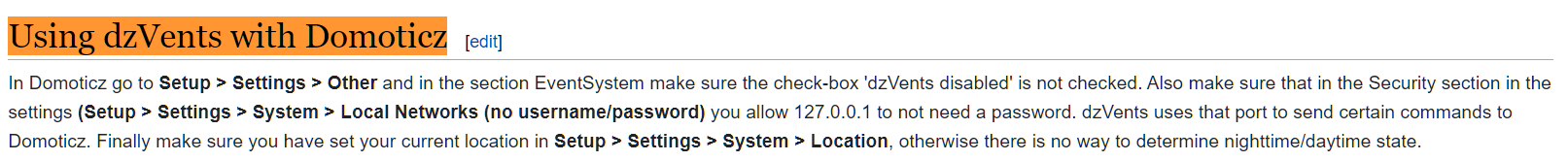

When not yet familiar with dzVents please start with reading https://www.domoticz.com/wiki/DzVents:_ ... _Domoticz before implementing.
Special attention please for "In Domoticz go to Setup > Settings > Other and in the section EventSystem make sure the checkbox 'dzVents disabled' is not checked. Also make sure that in the Security section in the settings you allow 127.0.0.1 to not need a password. dzVents uses that port to send certain commands to Domoticz. Finally make sure you have set your current location in Setup > Settings > System > Location, otherwise there is no way to determine nighttime/daytime state."
For you convenience I set the log level to DEBUG and made the notification subsystem configurable.
-- getMaxTempHum
local httpResponses = "getMaxTempHum"
    on      =   {
                    timer           =   { "at 21:43"    },                       -- Your preferred time
                    httpResponses   =   { httpResponses }
    logging =   {
                    level           =   domoticz.LOG_DEBUG,
                    marker          =   httpResponses
    execute = function(dz, item)
        -- ****************************** Your settings below this line ***************************************************
        temphumDevice           = dz.devices(766)          -- Replace with ID of Device you want to be notified on
        -- notificationSubsystem   = dz.NSS_PUSHOVER          -- Replace with your subsystem of choice or nil to get a notication on all
        notificationSubsystem   = nil          -- This will cause the script to send a notification to all subsystems
        -- ****************************** No changes required below this line *********************************************
        local extremes = {}
        local function logWrite(str,level)
            dz.log(tostring(str),level or dz.LOG_DEBUG)
        local function triggerJSON()
            local  URLString   = dz.settings['Domoticz url'] .. "/json.htm?type=graph&sensor=temp&range=day&idx=" .. temphumDevice.id
            dz.openURL({    url = URLString,
                            method = "GET",
                            callback = httpResponses })
        local function convertTime(timeString)               -- based on incoming format yyyy-mm-dd hh:mm

and now the script executes but i have a different error....
2019-01-19 16:33:00.437 dzVents: Info: getMaxTempHum: ------ Start internal script: GETMAXTEMP:, trigger: at 16:33
2019-01-19 16:33:00.453 dzVents: Debug: getMaxTempHum: Device-adapter found for Oregon TempHygro Starck Ext: Temperature+humidity device adapter
2019-01-19 16:33:00.458 dzVents: Debug: getMaxTempHum: Processing device-adapter for Oregon TempHygro Starck Ext: Temperature+humidity device adapter
2019-01-19 16:33:00.459 Error: dzVents: Error: getMaxTempHum: An error occured when calling event handler GETMAXTEMP
2019-01-19 16:33:00.459 Error: dzVents: Error: getMaxTempHum: ...omoticz/scripts/dzVents/generated_scripts/GETMAXTEMP.lua:101: attempt to index local 'item' (a nil value)
Re: dzVents: MaxMin Temp and Humidity
AYAMY wrote: Saturday 19 January 2019 16:39 thanks for your help..i have used your new code....
Can you please check again if the copy/ past3 went OK and that you only changed the time and the device number ?
In the version I posted line 101 is triggerJSON()
The error message shows that there is something else now on line 101
If you changed other lines please send me your changed version via PM so I can have a look what caused this error

the log result
2019-01-20 11:29:00.157 dzVents: Info: getMaxTempHum: ------ Start internal script: DzIII:, trigger: at 11:29
2019-01-20 11:29:00.174 dzVents: Debug: getMaxTempHum: Device-adapter found for Oregon TempHygro Starck Ext: Temperature+humidity device adapter
2019-01-20 11:29:00.179 dzVents: Debug: getMaxTempHum: Processing device-adapter for Oregon TempHygro Starck Ext: Temperature+humidity device adapter
2019-01-20 11:29:00.179 Error: dzVents: Error: getMaxTempHum: An error occured when calling event handler DzIII
2019-01-20 11:29:00.179 Error: dzVents: Error: getMaxTempHum: ...ntu/domoticz/scripts/dzVents/generated_scripts/DzIII.lua:100: attempt to index local 'item' (a nil value)
2019-01-20 11:29:00.179 dzVents: Info: getMaxTempHum: ------ Finished DzIII
at line 100 in the event editor inside domoticz i can olny see this...
line100
line100
AYAMY wrote: Sunday 20 January 2019 11:35 the code with my changes
Strange. I use the exact same code and it works. What is your domoticz / dzVents version ?
And can you change line 100 to
if item.isTimer or item.isDevice then
To see if that does change the behavior ? Thanks

2019-01-21 08:53:00.389 dzVents: Debug: getMaxTempHum: Processing device-adapter for Imagintronix: Temperature+humidity device adapter
2019-01-21 08:53:00.389 Error: dzVents: Error: getMaxTempHum: An error occured when calling event handler DzIII
2019-01-21 08:53:00.389 Error: dzVents: Error: getMaxTempHum: ...ntu/domoticz/scripts/dzVents/generated_scripts/DzIII.lua:101: attempt to index local 'item' (a nil value)
2019-01-21 08:53:00.389 dzVents: Info: getMaxTempHum: ------ Finished DzIII
Thanks for your help @waaren

        if not item.isHTTPResponse then
            triggerJSON()
        elseif item.ok then                                      -- statusCode == 2xx
            extremes = getExtremes(item.json.result)
            notify(getTimeWindow(timeSpan))
            logWrite("Could not get (good) data from domoticz. Error (" .. (item.statusCode or 999) .. ")"  ,dz.LOG_ERROR)
            logWrite(item.data)

and Now the script doesn't run.... it has these errors
2019-11-18 16:37:00.527 Error: dzVents: local netWork not open for dzVents openURL call !
2019-11-18 16:37:00.527 Error: dzVents: check dzVents wiki (look for 'Using dzVents with Domoticz')
AYAMY wrote: Monday 18 November 2019 16:41 I have upgraded to Domoticz
In case you don't have access to the dzVents wiki
Using dzVents.png (54.03 KiB) Viewed 2310 times
AYAMY
Posts: 21
Joined: Sunday 27 May 2018 11:51
Post by AYAMY »
my bad.... sorry....
I have a Fritzbox... and using 192.168.0.* doesn't work ... Fritz releases 192.168.178.* so i have added 192.168.178.* and now it works...
