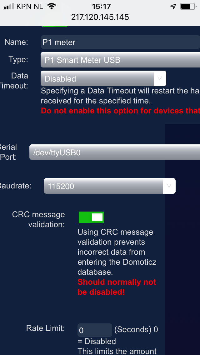

Hey. Thank al for the help. I dit der that the rate limit of the p1 USB hardware is 0. If i increase that the CPU is going down.
Re: 2 minutes delay in device trigger DZVents in log
klaaspiet wrote: Sunday 30 December 2018 15:19 the rate limit of the p1 USB hardware is 0. If i increase that the CPU is going down.
The value of 0 is the default. The CPU usage will go down if you raise it but I expect that this is not the root cause of your CPU usage problem.

I set the rate limit on 120sec. And now my CPU is 21 25%. And my scrips are working fine.
