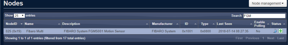

Could you tell me from the openzwave node list, what ID/Type you have ?
Mine is 0x1001, 0x0800, i have included this on a non-zwave+ stick
