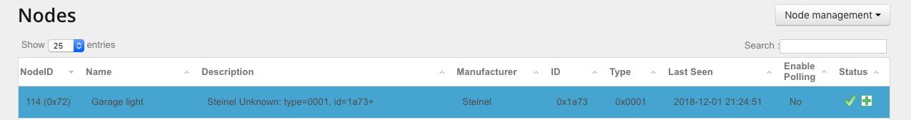

This is what I have done so far:
Screenshot 2018-12-01 at 23.24.51.png (29.54 KiB) Viewed 1333 times
and added to the manufacturer_specific.xml the following code:
<Manufacturer id="0271" name="Steinel">
		<Product type="0001" id="1a73" name="XLED Home 2" config="steinel/xled-home-2.xml"/>
	</Manufacturer>
However when I re-start domoticz, still does not load the configuration file
11101101 - www.machinon.com
