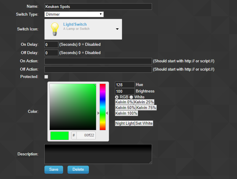

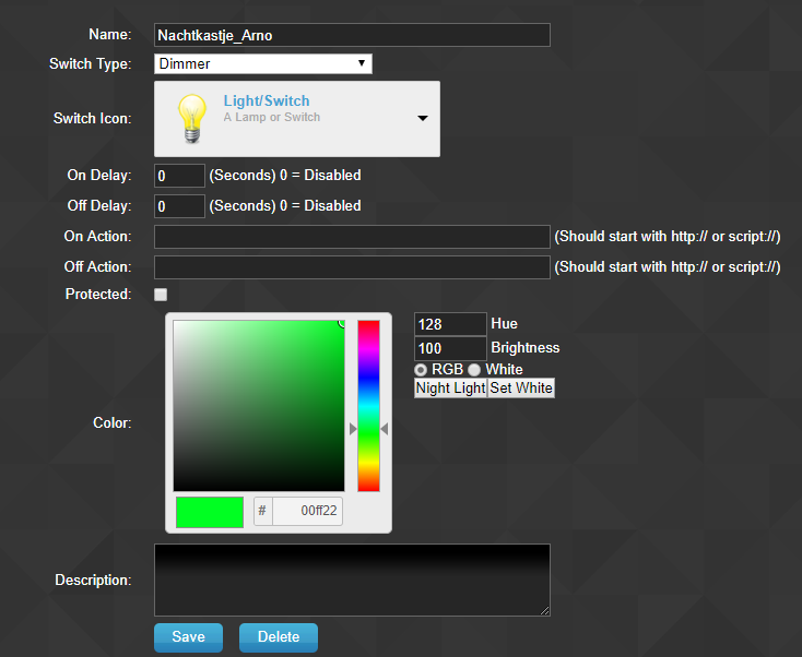

1) Using Milight Box the lamps also have Kelvin options.
2) Using Milight and RFlink the Kelvin option is gone.

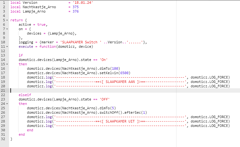

Here a example of my dzVents script:
behind the scenes the dzVents system have many action to activate the action within Domoticz and its devices.
(Danny correct me if i'm wrong)
local Version               = '18.01.24'
local MasterBedroomSwitch	= 90
local MasterBedroom		    = 7
    active = true,
        devices = {MasterBedroomSwitch},
    logging = {marker = 'SLAAPKAMER Switch ' ..Version..'......'},
    if
    domoticz.devices(MasterBedroomSwitch).state == 'On'
    then
        domoticz.devices(MasterBedroom).dimTo(100)
        domoticz.devices(MasterBedroom).setKelvin(5000)
        domoticz.log('--------------------------------------------------------------', domoticz.LOG_FORCE)
        domoticz.log('-------------------==<[ SLAAPKAMER AAN ]>==-------------------', domoticz.LOG_FORCE)
    elseif
    domoticz.devices(MasterBedroomSwitch).state == 'Off'
    then
        domoticz.devices(MasterBedroom).dimTo(5)
        domoticz.devices(MasterBedroom).switchOff().afterSec(1)
        domoticz.log('-------------------==<[ SLAAPKAMER UIT ]>==-------------------', domoticz.LOG_FORCE)

I mean with original Milight Bridge I get this for RGB CCT lamps:
With the RFLINK I only get these options:

This is the result of the following script, any idea why kelvin isnt working?
    then
Your understanding us wrong i think.
