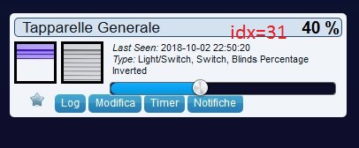

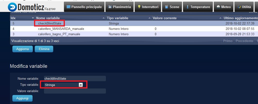

i try to adapt your code and i create this:
i create a user var as string named: "checkBlindState"
this is my blind with percentage switch, that as id=31
and this is what is inside:
blind command.jpg (31.09 KiB) Viewed 3892 times

so all is ok, now related to the percentage:
i started to all close (domoticz 0%) then i short press wall switch UP -> 2sec activation relay UP -> i see in domoticz 40% open (why?!?!?) (the string checkBlindState is closed)
then i short press again wall switch UP-> 2sec activation relay UP -> i see again in domoticz 40% open (same as previous) (the user string checkBlindState is closed)
then i long press again wall switch UP -> 10sec activation relay UP -> i see in domoticz 100% open (the user string checkBlindState now is open)
when i short press wall switch DOWN -> 2sec activation relay DOWN -> i see again in domoticz 0% (all close) (the user string checkBlindState is closed)
when i long press wall switch DOWN -> 10sec activation relay DON -> i see in domoticz 0% (all close) (the user string checkBlindState is closed again)
i do not understand....
