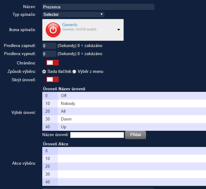

1) defined virtual Selector switch for manual control
2) defined Event for this Selector
But when Selector switch is changed, nothing happens... Any hint? Thanks

I think you need to place the number of the rule after the = sign, not the name you gave it.
So:
if selector = 0 then
if selector = 10 then .....

I use the selector level like this:-

mrf68 wrote: Sunday 02 December 2018 19:18 I think you need to place the number of the rule after the = sign, not the name you gave it.
So:
I tried this before playing with strings, but with no luck.

HM, I tried add some log messages for IF ELSE conditions. And in log, there are right messages based on selected value on Selector switch. So, condition is working right. But setting setpoints is not working.

Another observations:
Created virtual switch and it can control Setpoints. So no problem with blockly conditions, no problem with SetSetpoint... may be, problem is with switch selector virtual device.

Have you tried it like this:-
if selector = Level % 10 then .....
Because I have that working for sure. ;)

No, selector as Level in % does not working for me. So as not working only number.
Only way is to check conditions as "string". It is working. Not sure why not work directly SetPoint for radiator valves, but when I am controling from selector virtual thermostat, it works as I wish.
