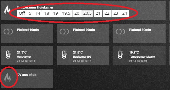

Hi fellow users,
Recently I've started using Dashticz and it's looking great and also very flexible, there seems to be a lot to learn :shock: .
But I'm running into some strange behaviour and hope that somebody is willing to help me.
I've installed Dashticz v2.3.3 master on a synology server and Domoticz is running on a RPI3B+.
Some background info:
I've created a selector switch with different temperature values.
I've got a switch that turns on and off my CV.
On Domoticz I'm running SVT (Smart Virtual Thermostat).
When I change in Dashticz the temperature, so the CV will turn on, e.g. "23 graden"
The CV indicator on Dashticz "CV aan of uit" doesn't change. Allthough Domoticz is turning on the CV switch!
When I push "23 graden" again, the switch "CV aan of uit" in Dashticz is changing state!?
The same behaviour appears when I want to turn off the CV, by selecting a low temperature, e.g. "14 graden".
When I do the same thing in Domoticz (and it does run already a long time) everything is reacting promptly and consistent.
Tried different browsers: IE and Chrome and the have no differences.
A screenshot attached
Thanks in advance, Johnnie

Dashticz uses two mechanisms to update the status of devices:
1) Automatic refresh in the background every xxx seconds, defined via config['domoticz_refresh'] = '5' in CONFIG.js (for a refresh rate of 5 seconds)
2) Refresh of all devices after you press a switch in dashticz.
If you set a new temperature in Dashticz then Dashticz directly after that will request a device update from Domoticz. It might be that the CV has not been switched on/off directly, meaning that Dashticz will still show the old value. However, within 5 seconds the status in Dashticz should be the same as the status in Domoticz.
I strongly recommend to use the beta version of Dashticz. The beta version contains some improvements related to refresh of device info.

Hi Lokonli,
Thanks for you're explanation, since I posted the request I've done several things:
  • Waited some time, to make sure that it refreshes, no luck
  • Installed an older raspi (webserver only and for reference with syno), installed Dashticz V2 beta
  • Checked CONFIG.js, compared it with some examples. Finally made some changes and corrections
  • Installed on the syno also the beta version (by you're advise) and kept for refernce the "master" version as well
Findings:
  • CV-switch is updating, On the rpi-beta en syno-master&beta. But I'm not there yet, because:
  • When I toggle a switch a few times I receive an error and Dashticz and its not responsive as before
  • On the syno-master, the message for updating is always appering when I do F5 !?
  • On the syno and rpi-beta, there is no error, but dashticz is not working correctly. After toggling a switch I'm losing synchronisation. E.g. Dashticz shows that light is "on" but for real the light is "off" (also in domiticz the light is off)
  • And the custom icons and coloring on both beta's are not working?
My conclusion:
CONFIG.js contains a fault!?
Dashticz-beta doesn't work properly with custom icons and coloring?
Hopefully somebody can help me detemine what is wrong.
Also I posted the CONFIG and some pics showing; error, custom icon, coloring and no-icon-coloring.

johnnie wrote: Friday 07 December 2018 16:35 Hi Lokonli,
Findings:
My conclusion:

I see only one small mistake in your CONFIG.js. In Dashticz-beta we switched to a new FontAwesome version. You have to select the right symbol as follows:
blocks[762]['icon'] = 'fas fa-pause'
Frequent toggling of a switches will indeed give the red connection error. (It should however not have really impact on the performance). There is a PR on that, so that will be merged in the next beta. If you want to test please send me a PM.
johnnie
Posts: 37
Joined: Wednesday 10 December 2014 21:08
Domoticz version: 4.10717
Re: Update status switches Domoticz - Dashticz not "always working"
Post by johnnie »
Hi Lokonli
Thanks that did the trick and also explaines it!
Best regards Johnnie
