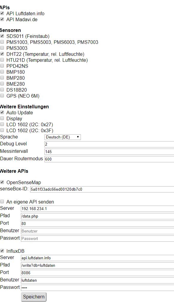

I build my own Dustsensor (https://luftdaten.info). I now would like to use the Data in Domoticz. There are only Scripts for Fhem and HAss.
The Sensor also showa data in an Json File like this:
{"software_version": "NRZ-2017-099", "age":"139", "sensordatavalues":[{"value_type":"SDS_P1","value":"7.63"},{"value_type":"SDS_P2","value":"4.23"},{"value_type":"temperature","value":"8.30"},{"value_type":"humidity","value":"27.30"},{"value_type":"samples","value":"617412"},{"value_type":"min_micro","value":"229"},{"value_type":"max_micro","value":"25617"},{"value_type":"signal","value":"-67"}]}
Also its possible to use an own api. Now my question is how to get the Data into domoticz?
Sensors used with an Nodemcu are DHT22 and SDS011.

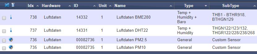

Step2 = lua-script which
- reads the 2nd xml-file with the name given in step1 [therefore do no change filenames in Step1 unless you know what you do!],
- dissects that file and extracts temperature, humidity, PM2.5 and PM10, and
- uploads the extracted information to Domoticz
[upload of temperature+humidity is towards a virtual sensor which mimicks a DHT22, and towards 2 Custum sensors for PM2.5 respectively PM10]

I have created a dummy device and some virtual sensors and use a LUA script.
local FQDN = 'IP DOMOTICZ'
        active = true,
                timer = { 'every minute' },
                httpResponses = { 'luftdatenRetrieved' } -- matches callback string below
                if (item.isTimer) then
                        domoticz.openURL({
                                url = 'http://' .. FQDN .. '/data.json',
                                method = 'GET',
                                callback = 'luftdatenRetrieved'
                elseif (item.isHTTPResponse) then
                        if (item.ok and item.isJSON) then -- statusCode == 2xx
                                if tonumber(item.json.age) < 60 then
-- 1: SDS_P1 PM10, 2: SDS_P2 PM2.5, 3: DHT22 temp, 4: DHT22 hum, 5: BME280 temp, 6: BME280 hum, 7: BME280 baro
                                        domoticz.devices('Luftdaten PM10').updateCustomSensor(item.json.sensordatavalues[1].value)
                                        domoticz.devices('Luftdaten PM2.5').updateCustomSensor(item.json.sensordatavalues[2].value)
                                        domoticz.devices('Luftdaten DHT22').updateTempHum(item.json.sensordatavalues[3].value,item.json.sensordatavalues[4].value,0)
                                        domoticz.devices('Luftdaten BME280').updateTempHumBaro(item.json.sensordatavalues[5].value,item.json.sensordatavalues[6].value,0,(item.json.sensordatavalues[7].value/100),0)
                                -- oops
                                domoticz.log('Error fetching Luftdaten data', domoticz.LOG_ERROR)
                                domoticz.log(item.data, domoticz.LOG_ERROR)
I'm also publishing the valuses at my site.
