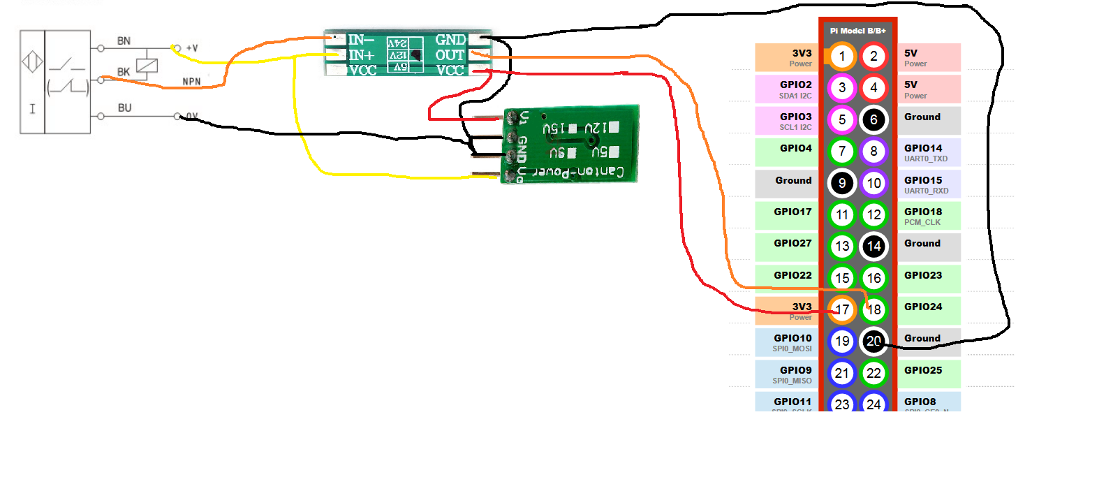

This sensor, LJ18A3-8-Z/BX 8mm, detects the printed circuit when passing by.
I made the same construction with a hose clamp and iron holder.
Working fine on 12V.
It is rather large, but no downside so far;
https://nl.aliexpress.com/item/LJ18A3-8 ... Title=true
Electrical connection attached.
Using a step-up 3.3v -> 12v and using a optocouper 12v->3.3v for the input.
Software done according to wiki, only modified the idx and gpio port of the script.
https://www.domoticz.com/wiki/GPIO_meter

Just received a new water meter and want to connect it to my Domoticz. I have a sensor type LJ12A3-4-Z/BX, doens anybody know if I can use this ? My Meter also has a printed circuit in the red marker..

I am trying to understand your drawing. Can you clearify to connections on the reed relais? The proximity sensor pull downs to ground if i am right but the reed switch does need power also isn't?Keptenkurk wrote: Wednesday 25 December 2013 16:12 Today i mounted and connected the proximity sensor and got it all working.
