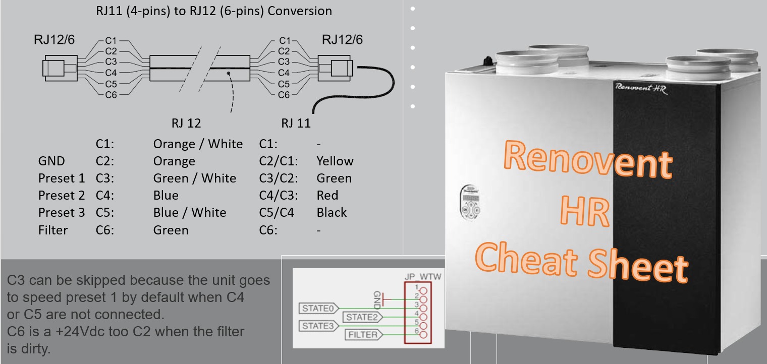

rrozema wrote: Sunday 03 June 2018 23:29 My home has a forced ventilation system (Dutch: WTW-unit or Warmte-Terug-Win-unit), keeping fresh air circulating in my entire house while keeping the heat in. The unit was regulated by a switch with 3 locations similar to this:
. That switch was however in the kitchen so it was never switched to 3 when someone went for a shower, and if it was, it was never put back to 1 afterwards or much to soon because of the loud noise. The result: mold and stains in my bathroom and condensed windows all over the house.
My take at this problem: automate the thing!
Components (I provide links to most items at robbshop.nl because they provide so many useful examples, including the one that initiated my project. I am not affiliated to them) : Later additions: Modifications to the ventilation:
My Fender WHR 930 Basic has 3 speeds: low, medium and high, represented by 1, 2 and 3 on the switch. Advice is to never switch the system completely off, but instead leave it at 1. When cooking, showering or for whatever reason you need more air flow, switch it to 2 or even 3. So I connected 1 to mains permanently and used the double relay to switch 2 and 3 on and off. What I did was to remove the switch from the kitchen and put a plate in front of the hole left in the wall, making sure the wires were connected such that I still had 220V in the wall socket upstairs. The connector is called a perilex-connector. This type of connector was originally designated for high power devices like for example electric cooking plates. It is also often used for ventilation units like mine. I found that different ventilation brands have different wiring for the connector, so if you've got a different brand be careful to connect the wires correctly! I found this very informative image at https://www.ventilatieland.nl/blog/22/p ... latie.html (the article is very helpful, but it's in Dutch), the picture should be clear even if you don't master the language:
. I put the Fibaro double relay inside the WTW unit, in the area that receives the cables. So all I needed was the blue and brown wires from the perilex connector and connect the terminals of the double relay to the 2 and 3 labeled terminals of the unit.
Humidity sensors:
I put one Everspring ST814 in my bathroom and another in the kitchen. Put the batteries in, paired them in domoticz with my home's z-wave network and ready. Not much more to it, really.
Connecting it all together:
I first copied bits of scripts found all over the internet, mostly in LUA, later I did a full rewrite in dzVents. This is when I really got carried away and added all sorts of features that made the script look rather impressive at first, but that's just because it does so much :-). I do not have earlier (simpler) versions of the script any more, so I am going to give you what I've got right now and tell you what it does later on:

May thanks for the scrip. I have same one unit with same one crapy 3 state switch. I was unable ti connect through Rs232. so I decided to make only 3 ssr switch and later if i have time make my own electronic for it. It's quite simple setup two fans with pwm input, fan diagnostic, bypass relay and ntc thermometers. But lots and lots of things to do...
If i understand correctly there is a dummy switch for stage 2 and 3? I would like to add some more conditions (like fireplace starting and additional kitchen went) maybe outside your script. My scrip knowledge i 0
Wysłane z mojego D6503 przy użyciu Tapatalka
rrozema
Posts: 470
Location: Delft
Re: Automating my WTW (ventilation unit)
Post by rrozema »
Even though I've included the z-wave double switch in the wtw unit (in the plastic covering on top, not inside the metal casing as to not reduce z-wave wireless range of the switch), I have only modified the 220V wiring, not the WTW unit itself. I wanted to be able to return to the original situation without having to buy a new WTW-unit :-).
I had a look at the mains cable going from the WTW unit into the Perilex wall-outlet and saw that both N and L were fed into the WTW unit. For my Zehnder WTW-unit, these are on pins "N" and "L3" in the perilex connector (see picture in my first posts). So I removed the switch in the kitchen and put a plate on the wall box to cover the hole. Then I removed the front plate(s) of the WTW unit and disconnected all wires from the WTW unit coming in from the perilex plug. I re-used only the wires coming from N and L (most likely blue and brown), the other wires are no longer needed. I covered them with tape them for safety (even though I know for sure I disconnected the other ends). The wires coming from N and L I connected to the terminal of the WTW unit, such that the unit will always run at low speed, then I used some additional short pieces of wire to feed the same blue and brown wires into the z-wave switch and connected another wire between the L1 on the switch and medium-speed terminal on the WTW, and the last between the high-speed terminal of the WTW unit. When it is plugged in, the unit runs at low speed, and I set it to medium and/or high speed using the double z-wave switch. It doesn't matter if the unit is set to 1, 2, and 3 all at the same time, the unit will simply run at the highest speed select. In my case it will always run at 1 or 1 & 2 or 1 & 2 & 3. This is by choice because this way it is easier to see in the logs in Domoticz when the unit was running at 1, 2 or 3.

I will be porting this solution (now Mysensors) to ESPEasy when I receive the parts from my dear friend Ali E.
Brinks Renovent

Based on the original Idea: https://forum.mysensors.org/topic/7180/ ... -systems/3
I'll take the ESP and allow it to control the Brinks from setting '1' to '3' as usually I never use ' 2' .
As this is a nice shield and doesn't cost that much.... It is worth a shot. Flashing it with ESP Easy and have it control the relais.
Interesting would be as well if I could add the Brinks filter warning to the ESP as well. That would need at least a buckconverter to drop the voltage to 3,3v input for the ESP. Zenernode.. possible but have not tested that yet..

I didn't test 1&2&3 together. I was based od schematic and manuals. I made simple 3way switch and power on in box for now and when moved in final location it will be 3 ssr. I still don't like that i have manually changed speed winter/summer but for now It must be that way. Image

Op het aansluitblokje van de printplaat in de WTW staat P 1 2 3. De draden vanuit de 3 standenschakelaar (code P, T1, T2, T3) zijn ook zo aangesloten P op P, T1 op 1, T2 op 2 en T3 op 3.
Vraag is nu hoe sluit ik de Kaku ACM 3500-3 aan?
Deze krijgt een eigen voeding, dit zit rechts op het apparaat.
Ik denk dat de aansluiting als volg moet zijn: Uitgang L1 op printplaat 1 (N1 blauw op printplaat P?)
Uitgang L2 op printplaat 2 (N2 niet gebruiken)
Uitgang L3 op printplaat 3 (N2 niet gebruiken)
Kan de huidige 3 standenschakelaar aangesloten blijven? En dan parallel gebruikt worden.
sincze
Posts: 1302
Domoticz version: 2024.4
Post by sincze »
Remelco wrote: Monday 17 December 2018 11:05 Ik wil een WTW Renovent 250 gaan schakelen met een Kaku ACM 3500-3
Helaas lukt het mij niet om een foto toe te voegen.
De WTW heeft geen perilex stekker maar een perilex printplaat. De huidige 3 standen schakelaar is met 4 draden aangesloten op de printplaat. ( gedaan door 2 kabeltjes, nu dus 2 keer blauw en 2x rood draad)
Ziet het er een beetje uit zoals deze cheatsheet?
https://forum.mysensors.org/post/83233
Oh ja ik zie idd een probleem met het uploaden van images: "Sorry, the board attachment quota has been reached."
Post by Remelco »
Hallo Sincze,
het lijkt er wel op. Het is een Brink WTW van bouwjaar 2000.
Foto's lukt niet (pm naar jou ook niet) maar misschien verduidelijkt onderstaande.
Aansluiting perilexprint in de WTW Renovent HR-CF 250
Perilexprint - aangesloten op 3 standenschakelaar
P op P
1 ,, T 1
2 ,, T2
3 ,, T 3
Moet ACM 3500-3 als volgt aangesloten worden?
Perilexprint - aangesloten op uitgang ACM 3500
P Op ACM3500 N 1
1 ,, L 1
2 ,, L 2
3 ,, L 3
En kunnen de draden vanuit de ACM bij de bestaande aansluiting van de 3 standenschakelaar in de perilexprint gestoken worden, zodat de schakelaar ook gebruikt kan blijven worden.
