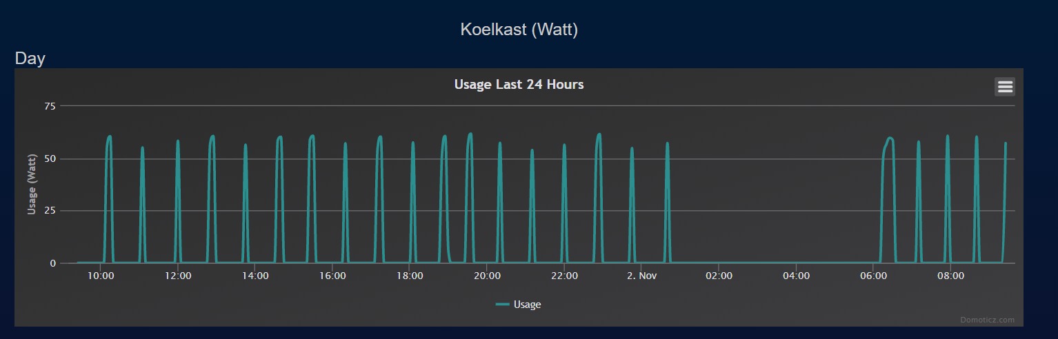

Ok so I remove the NEO from the 220v and unscrew the screw in the middle.
Any clues I should look for?
As the plug is hidden behind the kitchen, nobody is able to touch it.
This morning it was switched off again.. however Domoticz said it was still switched on.
Louis_WhatsApp Image 2018-11-02 at 09.28.30.jpeg (65.83 KiB) Viewed 3660 times
