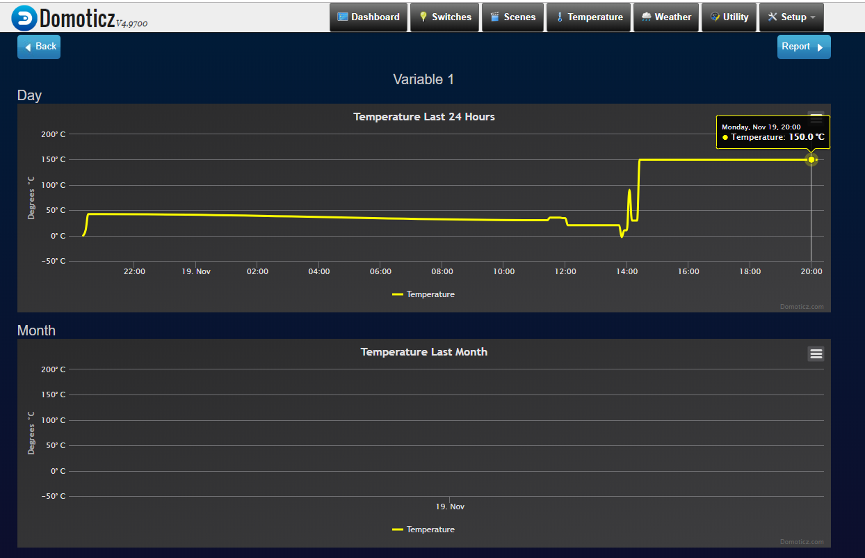

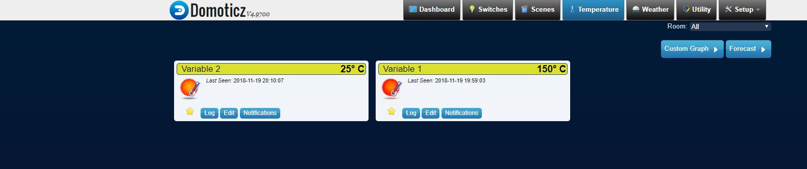

On domoticz i see my sensor see picture
setup device :
on my arduino code, i have duplicate code when send temperature on 433mhz and i have change ID(BC20 and BB20) so i can transmit different variable
temperature :
see max is 150.5°(150° on image) (if i ad a value more than 150.5, the real value are not displayed)
Graph :
see, i change variable on arduino code and value change on domoticz
Now if my explanation is understand ;)

second and third picture, sorry :)
