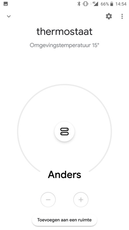

I am having problems with a setpoint device.
The current (set) temperature is displayed, but I cannot change the value.
The switches are greyed out, and status is reported as "other"
please see screenshot attached.
what am I doing wrong?

Hi TriStanp,
I face the same 'problem' but if you say to Google Assistant / Home 'zet verwarming in ruimte x op y graden' seems to work
So control with voice works but as interface on mobile it doesn't work at this moment ?

Hi, it's a wider issue with the home app - it works with the Home Hub, but not the phone app.
It does work with the Google Assistant however
