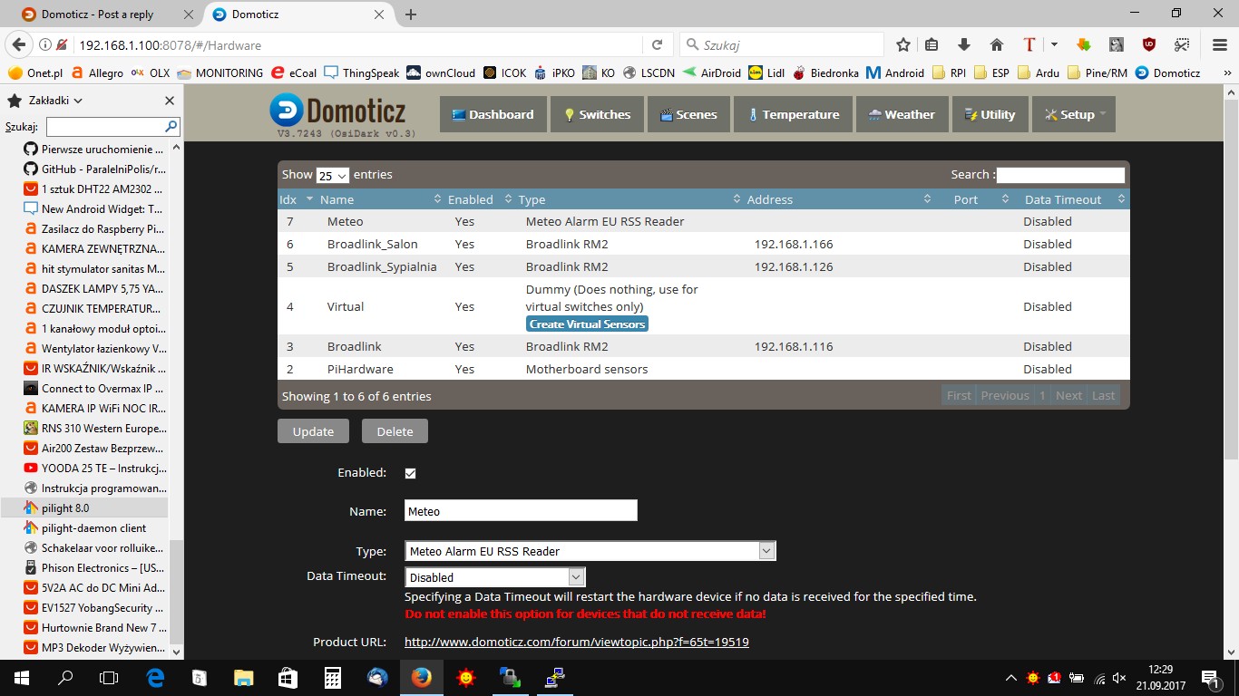

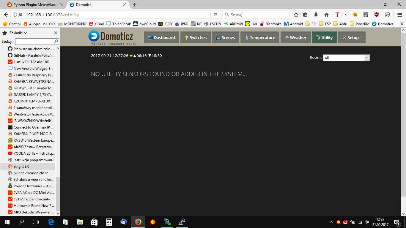

kniazio
Posts: 202
Joined: Thursday 06 October 2016 8:14
Domoticz version: 3.7243
Re: Python Plugin: MeteoAlarmEU
Post by kniazio »
It does not work for me
