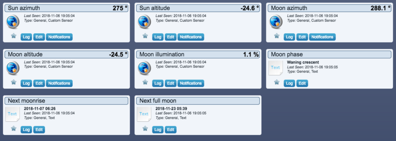

I've created the following Python script, which will send the following to Domoticz:
- sun azimuth (°)
- sun altitude (°)
- moon azimuth (°)
- moon altitude (°)
- moon illumination (%)
- moon phase
- date & time of next moonrise
- date & time of next full moon
The first 5 are custom sensors, the last 3 are text sensors.

Edit latitude, longitude and Domoticz values as appropriate.
Run this with cron, every 5 minutes (or whatever - the text devices don't need to be updated that frequently).
