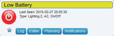

yellow = low battery

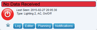

red = no data received during +3 days

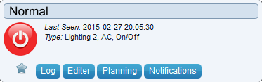

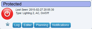

Re: device title color
'blue'
-> normal 'dark blue'
-> Device who is Protected 'yellow'
-> low battery
-> low battery

'red'
-> no data received during +3 days
did code it a litle different but does the same
anybody has an answer to the second question?
another thing
is it possible to set/change the temperature setting of dummy thermostat setting from the floorplan
http://test:[email protected]:8080/#/Floorplans
ok as user test it is not possible
but as admin i also can not change temp setting on floorplan
greet luberth
now=os.date("*t")
-- domoticz lua timed script to prevent red titlebars on dummy thermostat
-- http://test:[email protected]:8080/#/Floorplans
-- change % 1 to your desired reload minutes
if now.min % 1 == 0 then
local SetTempVent = tonumber(otherdevices_svalues['Ventilate Living start >']) -- get setting
commandArray[#commandArray+1] = {['UpdateDevice']='32|1|'..SetTempVent} -- set setting wih get setting
print("SetTemp ventilator updated to prevent red titlebars "..SetTempVent) -- print in log
local SetTempPump = tonumber(otherdevices_svalues['cv pomp setting pomp aanbij Berkhout<']) -- get setting
commandArray[#commandArray+1] = {['UpdateDevice']='31|1|'..SetTempPump} -- set setting wih get setting
print("SetTempPump updated to prevent red titlebars "..SetTempPump) -- print in log
return commandArray
Thanks for this tip! I also have sensors updated only once a day and just changed the setting to 1440!andreazan wrote: Thursday 23 May 2019 21:50 I have sensors that are updated once /day.
In a fresh installation of Domoticz 4.10717, the default in
settings -> Other settings -> Sensor Timeout is 60 minutes, not 3 days !
So, to consider acceptable a full day delay for an update and avoid the device title color to become red,
you should set this value to 60*24 = 1440.
