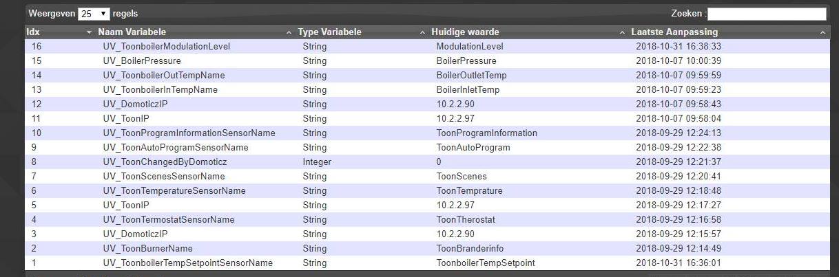

For who is interested, i've updated the current scripts since they where not working for me.
Also i've added the Boilermodulationlevel
Now it is a complete package with all the possible Toon sensors available.

-- uservariables
    ToonIP = uservariables['UV_ToonIP']
    DomoticzIP = uservariables['UV_DomoticzIP']
    ToonThermostatSensorName = uservariables['UV_ToonThermostatSensorName'] -- Sensor showing current setpoint
    ToonTemperatureSensorName = uservariables['UV_ToonTemperatureSensorName'] -- Sensor showing current room temperature
    ToonScenesSensorName  = uservariables['UV_ToonScenesSensorName'] -- Sensor showing current program
    ToonAutoProgramSensorName = uservariables['UV_ToonAutoProgramSensorName'] -- Sensor showing current auto program status
	ToonBurnerName = uservariables['UV_ToonBurnerName']
	ToonProgramInformationSensorName = uservariables['UV_ToonProgramInformationSensorName'] -- Sensor showing displaying program information status
	ToonBoilerTempSetpoint = uservariables['UV_ToonBoilerTempSetpointSensorName'] -- Sensor showing current internal boiler temp
	ToonboilerInTempName = uservariables['UV_ToonboilerInTempName'] -- Sensor inlet temperature
    ToonboilerOutTempName = uservariables['UV_ToonboilerOutTempName'] -- Sensor outlet temperature
    ToonboilerPressure  =   uservariables['UV_ToonboilerPressure'] -- ToonboilerPressure
    ToonboilerModulationLevel = uservariables['UV_ToonboilerModulationLevel'] -- Sensor showing current Boiler Modulation Level

http://10.2.2.90:8080/#UserVariables

Check if your user-variables are EXACTLY written as instructed. I made a typo in one of them, and it gave me the same error.

 There is no device with that name or id: ToonBoilerTempIn
There is..
 	UV_ToonBoilerTempIn	String	ToonBoilerTempIn	2018-11-03 11:22:08
