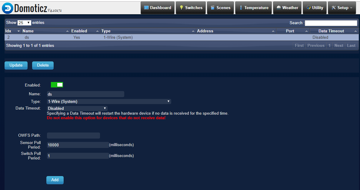

Hello!
I conected 2xDS18b20 to 4GPIO Raspberry PI.
pi@raspberrypi:~ $ ls /sys/bus/w1/devices/
28-119995116461 28-3b7882116461 w1_bus_master1
devices
Help plz. What is wrong? Why is only one DS18b20? And Where is 2nd?
