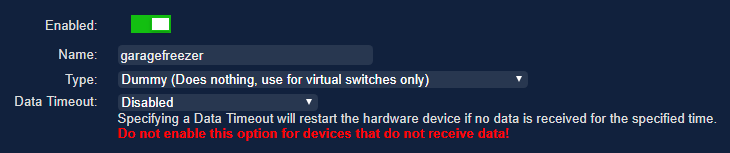

in settings > meters/counters I have
Meter/Counter Setup
Temperature:
Display: Fahrenheit
Degree Days (Base Temperature): 18.0
There are three [3] other mentions of the garage-freezer
-- setup > device = shows Fahrenheit, type = TEMP, sub-type = LaCrosse TX3
-- temperature > garagefreezer > notifications = shows Fahrenheit
The third place [below] I can't get the TYPE field to show TEMP which would match the device.
TEMP is not in the dropdown !!
Does this assist you in helping me get the notification svalue converted from C to F?
Thanks for sticking with me
Jim
