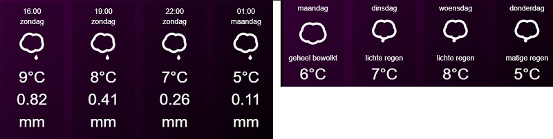

In (last minute) preparation of the switch off of WU, I did another test with weather underground.
I have the 'weather' block in my dashboard, showing the weather forecast for the next couple days.
When I change to 'weather_owm', it shows me 4 elements for the next 12 hours instead.
I would appreciate my 4 day forecast back, while using OWM. Is that possible?

I made a modification to show forecast for the next days with OWM.
It works great, but there's a little downside, I modified weather_own.js for this.
So when you update to a new version, the file will probably be overwritten.
Maybe it is possible for the developer(s) to implement this in the beta??
To use this, overwrite the content of weather_own.js with the code below (make a backup of the file first)

I introduced two new options, owm_days and owm_lang:
config['owm_api'] = 'xxxxxxx'; 		// Your OWM API key
config['owm_city'] = 'Amsterdam';	// Your city or nearby city to use in OWM
config['owm_name'] = '';		// If your city is not available with OWM, you have to use a nearby city. You can type the name of your own city here to show it in Dashticz
config['owm_country'] = 'nl';		// Your country to use in OWM
config['owm_cnt'] = 4;			// Number of columns to show. If showing days, max is 5
config['owm_days'] = 1;			// Enter 1 for showing forecast in days, 0 for the OWM default 3 hour forecast
config['owm_lang'] = 'nl';		// Set language for de description of the forecast (rain, cloudy, etc.). For available languages, see https://openweathermap.org/forecast5/#multi
config['static_weathericons'] = 0;	// Enter 1 for animated weather icons, 0 for static icons
Daily forecast.jpg (38.83 KiB) Viewed 3230 times

@toro Nice, thank you very much! It works well. One weather question. I see for the coming 4 days 4 different temperatures, but the same weather forecast (light rain). Since I don't like the light rain every day, this might be a bug? ;-)
toro
Posts: 50
Joined: Wednesday 09 August 2017 23:05
Re: Import weather data other than Wunderground
Post by toro »
jake wrote: Sunday 13 January 2019 19:28 @toro Nice, thank you very much! It works well. One weather question. I see for the coming 4 days 4 different temperatures, but the same weather forecast (light rain). Since I don't like the light rain every day, this might be a bug? ;-)
You'r welcome. It's probably because there actualy is light rain for the next days. ;) You can check on openweathermaps.org if this is the case. There might be some difference, forecast for the days is on the specific day at 13:00h, 14:00h or 15:00h.
