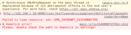

Hi!
Having the same issues with mine, but there I think i've found the fault...
When running the Dashticz on a low end computer as RPI on WiFi there seems that the connection to Domoticz server times out.
When running on my High-End computer i've never encounter this error....
See this error in Chrome runing in RPI:
Maybe there should be an option to add something like this:
config['domoticz_timeout_reload'] = '10';
Where the timeout is defined in seconds and Dasthicz should try to reload the data from Domoticz?
Now it just halts and does not even try to reload. Only when Dasthicz is refreshed it reloads the data ..

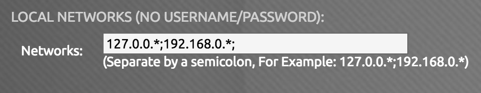

rgroothuis
Posts: 347
Re: Error: "Double check path to domoticz in settings!"
Post by rgroothuis »
Lokonli wrote: Sunday 04 November 2018 21:37
rgroothuis wrote: Sunday 04 November 2018 20:08 Same issue on my side as well. Hope there is a solution at some stage.
I propose to first test without username/password. In Domoticz you can set the subnets that don't require a user/password combination.
If it's working without user/password, then you may enable user/password checking again in Domoticz.
In Dashticz use the following settings in CONFIG.js:
config['user_name'] = 'username';
config['pass_word'] = 'password';
For connections from the local network I'm not making used of a login name and password.
Screen Shot 2018-11-04 at 21.39.57.png (114.65 KiB) Viewed 1455 times
Minglarn
Posts: 214
Domoticz version: v3.8153
Location: Stockholm / Sweden
Post by Minglarn »
The same here... no user/pass for local networks.
The switches and all work, it just do not update status and time for switches and temperatures. Strange.
