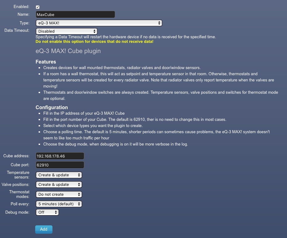

I disabled Thermostat modes:
After that it worked. For now I dont get 2 Temperatures, other 3 are right. But I think it could be a connecting Problem between Valve and Cube and has nothing to do with your Plugin.
