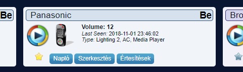

hi,
when i put https://10.0.0.91:55000/json.htm?type=c ... =getvolume in browser address line, no answer is arrived, anyway pugin is ok, what could be wrong?
the aim is "setvolume", for predefined volume after automatic powering on tv set in morning
thx
moo2089
Posts: 32
Joined: Sunday 25 March 2018 23:30
Domoticz version: 11804
Location: Budapest/Hungary
Re: Panasonic TV Support
Post by moo2089 »
moo2089 wrote: Thursday 01 November 2018 23:59 hi,
thx
solved, need to use domoticz ip and port:"http://<domoticz_ip>:8080/json.htm?type=command&param=panasonicmediacommand&idx=44&action=VolumeUp" :lol: :lol: :lol:
