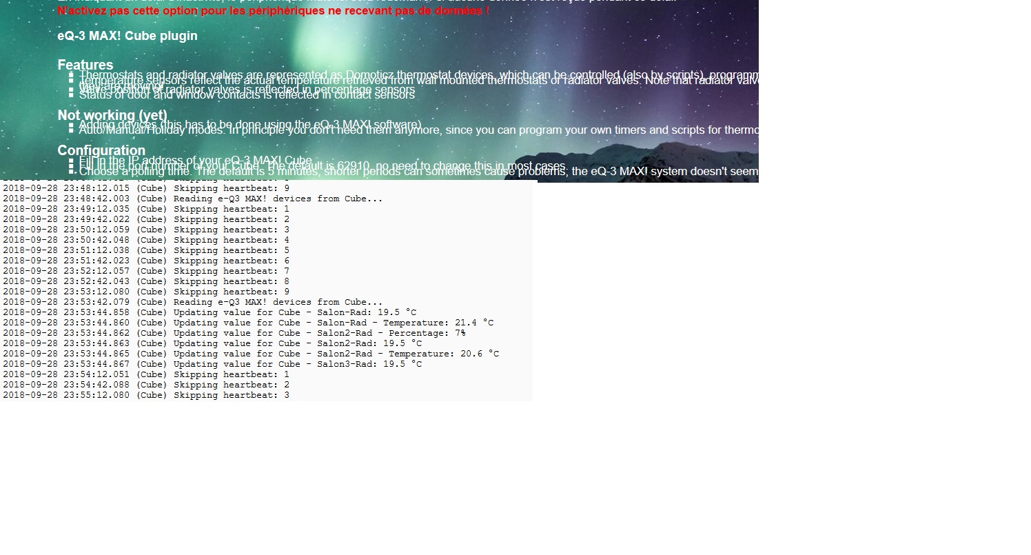

Small glitch on FireFox/Chrome and IE as attached
in the log is it possible to write set point ... and remove the word temperature ...just in my opinion
Great to hear it works for you!
The glitch is known, I had it too. It seems to be an issue with the Elemental theme, other themes don't suffer from this effect.

2018-09-29 14:32:23.022 Error: (MAX!) ----> Line 179 in '/home/pi/domoticz/plugins/MaxCube/plugin.py', function onHeartbeat

This log only contains the lines related to the MAX plugin, weird... If I cannot see the logging I don't know what is going wrong.
On which system are you running Domoticz?

I reboot the raspberries, cleared the cache, turned on the debugging again.
2018-09-29 16:02:52.943 (MAX!) Debug logging mask set to: PYTHON
2018-09-29 16:02:52.943 (MAX!) Debugging mode activated
2018-09-29 16:02:52.943 (MAX!) Reading e-Q3 MAX! devices from Cube...
2018-09-29 16:02:52.497 Status: (MAX!) Stop directive received.
