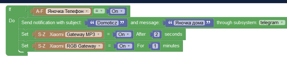

Can you please share how to play custom mp3 in Blocks?
I've added Xiaomi Gateway MP3 block but it doesn't play nothing :(
Thanks.
