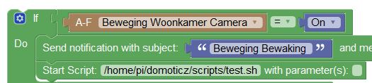

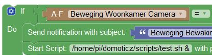

The blockly script call:
When i add a space and & it seems to work and domoticz executes the script.
2018-09-23 11:21:56.573 Status: Executing script: /home/pi/domoticz/scripts/test.sh &#[/b]

seems sendmail and ssmtp were conflicting or something like that
removed sendmail completely,
reinstalled ssmtp and heilroom-mailx and mailutils
removed the -A gmail
now got it working with below command in blockly script call:
///home/pi/domoticz/scripts/script.sh &
