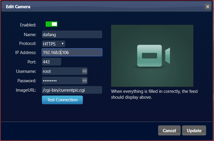

today i received the Xiaomi Dafang camera and succesfully applied the hack,
The only problem i have now is that i cant use the camera in Domoticz.
I can add the camera with /cgi-bin/currentpic.cgi as imgURL and when i click the test connection button i can see the picture.
But then after i add the camera i have no picture in domoticz.
i tried the solution provided in this topic but that did not solve the problem for me:
viewtopic.php?f=35&t=23909&p=185375&hil ... ng#p185375
Can someone help me with this?
Thanks in advance

I have the same problem, test picture is OK, but the live is not.
But, I tried HTTPS, port 443, root/ismart12, using /cgi-bin/currentpic.cgi. Test picture is not ok, but the now i can see the picture in the camreas section. Strange but works.

I have the camera working with these settings:
password is ismart12
Preview is not working but that's not an issue for me.
