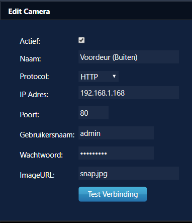

When I start from zero, I will lose everything, also my camera set-up in Domoticz, and I lost my password of my camera :( I searched in couple of files on Domoticz to find my camera password but I can't find it. Is it possible to find your camera password in a file?

Using firefox or internet explorer, or edge
open the above page
press F12
in the section that opens at bottom, select the top left icon "box+ arrow"
move your cursor until you selected the password box
now look in section at bottom !
where it stays: type = "password"
then replace "password" by "text"
And your password will appear..

Tnkx! That is the answer I was looking for! :D
