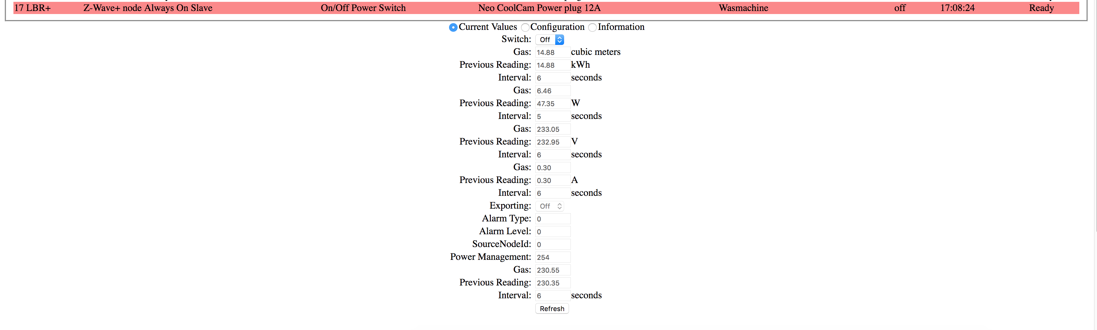

Today I noticed that one of my Neo Coolcam PowerPlug was not giving all it's information to domoticz..
It looks like it is still negotiating with domoticz looking at the hardware list. but when I look in the Control panel I have some strange readings..
one thing is that the switch is off (while it is actually on) and for some reason I have gas meatering ?.. (see pic)
Anyone an idea?

Yes, some hardware is very strange indeed. Thats why i stick to some known brands.
This is unfortunately not a Domoticz issue.
You can try to exclude it and include it again, if that does not work, you can edit the configuration file to disable using that gas meter
