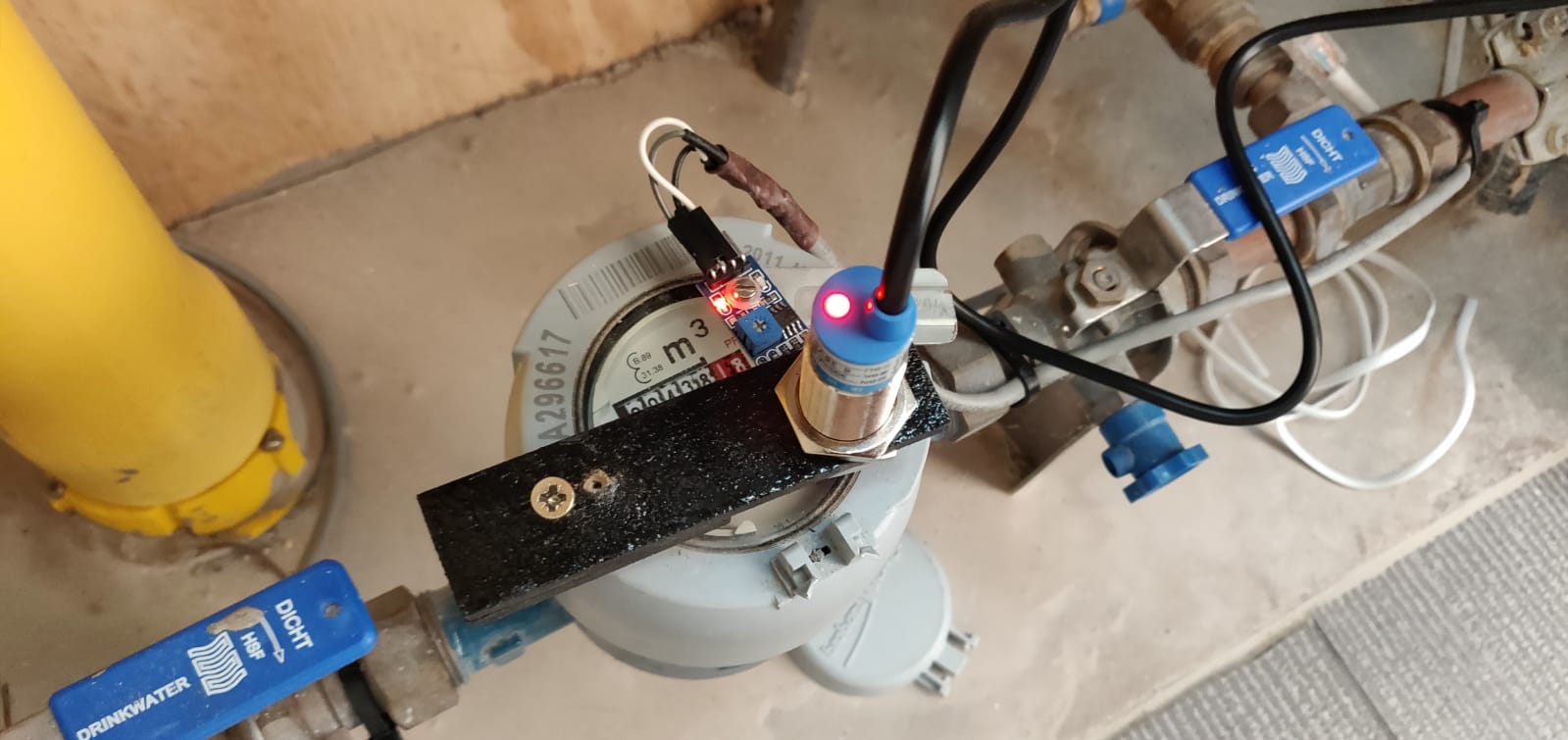

After several years of having a TCRT-5000 as a watermeter I decided to check out the NPN as well.
NPN Meter.jpeg (109.91 KiB) Viewed 3455 times
TCRT is connected to the Raspberry pi. The NPN is attached to a WEMOS to create a wireless solution.
In the image you can see the test setup.
Not a lot of room over the watermeter wheel, but just sufficient to have both meters up and running.
