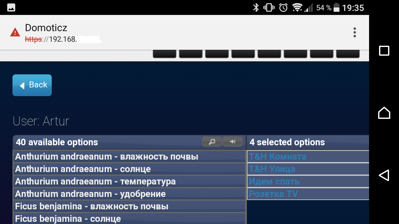

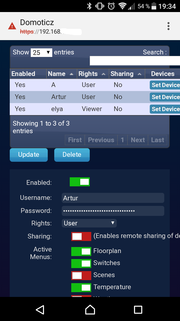

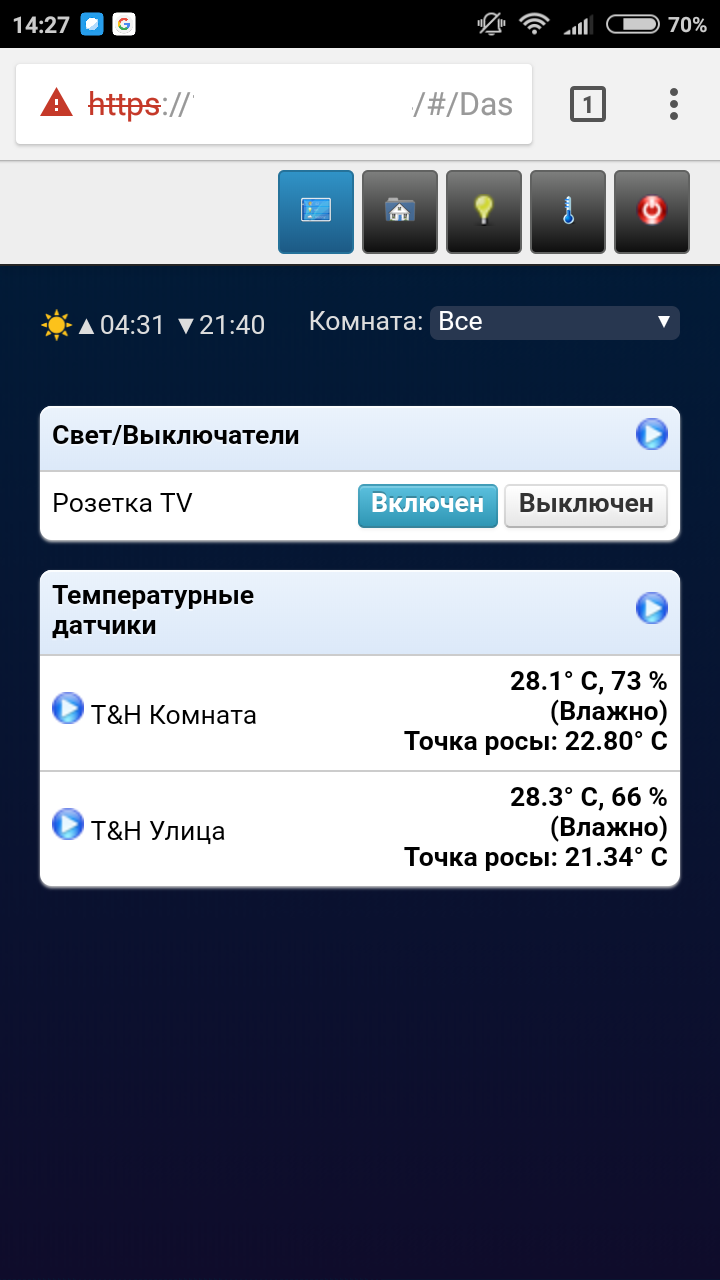

Hello friends, can you help me?
I want to give limited access to my child in the domoticz - only two switches he can to switch.
I create user "artur" and gave him access to the tabs "switches" and "temperature" only. After that I give him access only several devices:
When user Artur logged in domotics use Mobile Chrome it work correctly:
He can view and can control only two switches.
But if he use app Domotics Lite, he can see and manage more - Events, User variables and Scenes.
How to limit access to user Artur in app Domotics Lite?

tudimon
Joined: Thursday 30 March 2017 8:16
Re: user access or property administration
Post by tudimon »
other screenshots:
