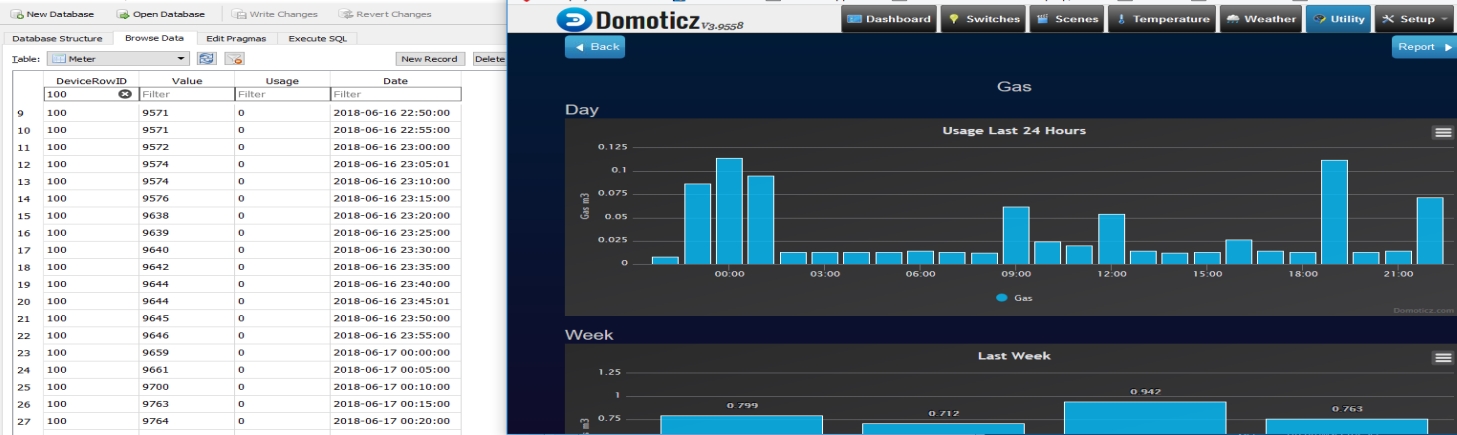

My gasmeter updates every 5 minutes, not every hour. Pls see attached picture: a screenshot of the domoticz database (so stored values) and the graph (only once per hour) of my Idx (gasmeter).
I have the same with other counters: I have a counting interval for them of 6 minutes (and that is also stored in the database) but the graphs only show the updates once per hour.
That is why I would like to create a graph like the electricitiy - that type of graph is able to show the shorter intervals!

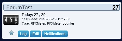

The counter in the Gui increases every minute, but decreases its interval time from 1 per minute down to once per 5 minutes value (stored in the domoticz.db)
Please note the displayed value "Today 27,29"
180619 Forumtest.jpg (12.81 KiB) Viewed 7371 times

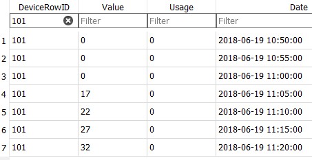

Actually counted 29, but in the database only the once per 5 minutes value (27) is stored

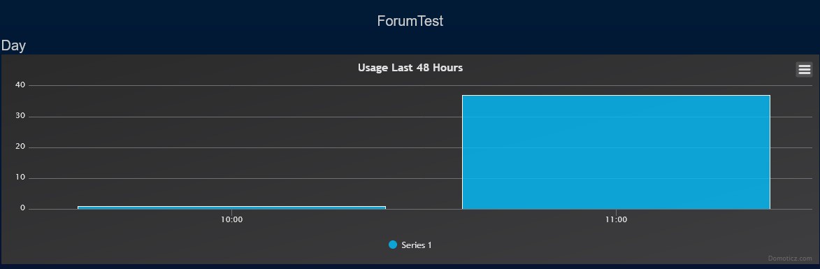

And within the graph I only get hourly updates:
180619 Forumtest graph.jpg (27.06 KiB) Viewed 7371 times
