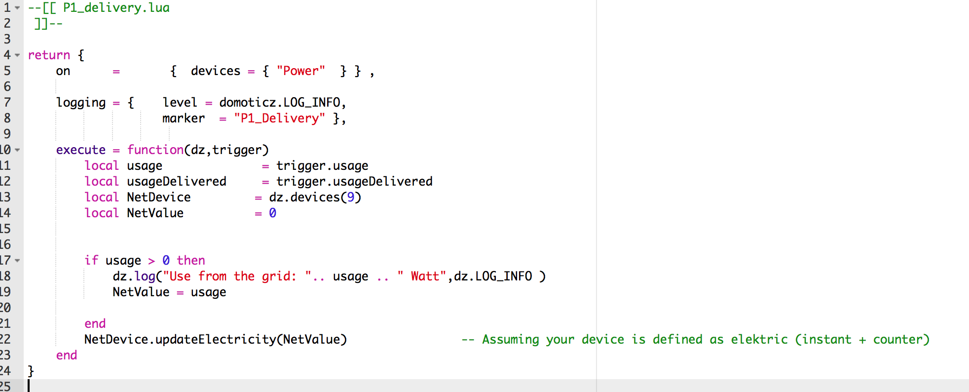

Hi, after a while using this script, I can see the actual power in "Watts" but the "KWH counter" doesn't work.
Wat isn't correct in the script?
Can you help me with this!
