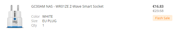

next time you see them at that price, let me know!!!sincze wrote: Thursday 21 June 2018 10:44 My aiming price is around 15-17 euro's. Even if I don't need them I buy them at these prices.

Yo got it!. Sometimes ' they' hide the direct link.
I daily search using ia VPN on TomTop / GearBest / AliExpress. Using 'Neo Coolcam' ,' Xiaomi Sensor' to see what comes up cheaply. (yes I use both zwave and zigbee).
They sometimes even never show up if I search from my home pc directly.
Seems they know the Dutch Cheapass guy already..... If I find any I'll post the direct link to the goods.
Due to Dutch customs you can only order 1 at a time... otherwise happy import-tax. And that would make it expensive again.
