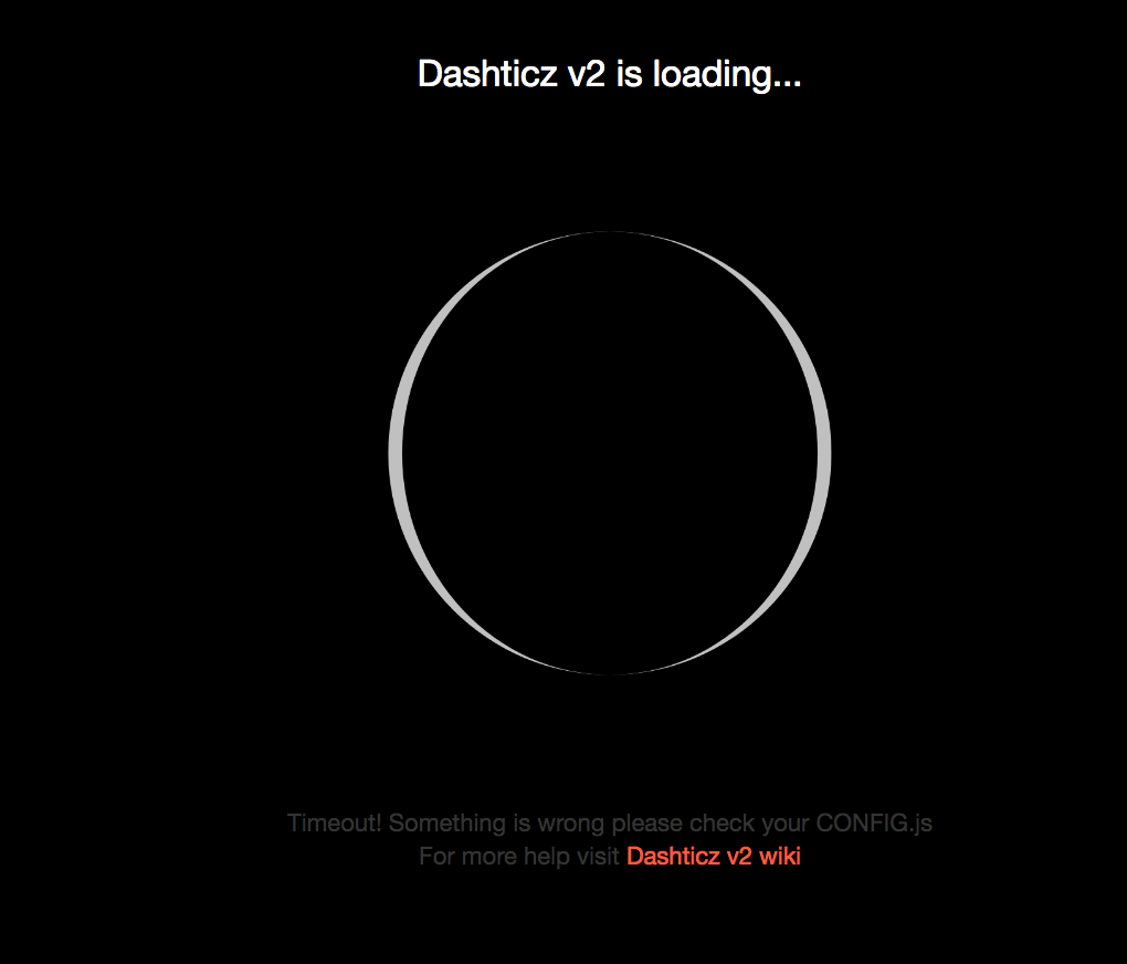

when i remove the first /* (including the line with text) and last /* to use the default config it stops working :?
message
time out something is wrong check your config.js.
sorry for all the questions. it is the first time using it.
Domoticz 3.8153 on linux laptop ubuntu 17.10 | Toon Thermostat | RFlink usb gateway
DewGew
Posts: 581
Domoticz version: V4.10618
Location: Sweden
Re: Dashticz - Save CONFIG.js automatically with PHP
Post by DewGew »
Change :
columns[1]['blocks'] = ['currentweather_big','weather','garbage']
to
columns[1]['blocks'] = ['currentweather_big','weather']
You have to define 'garbage' settings before using it.

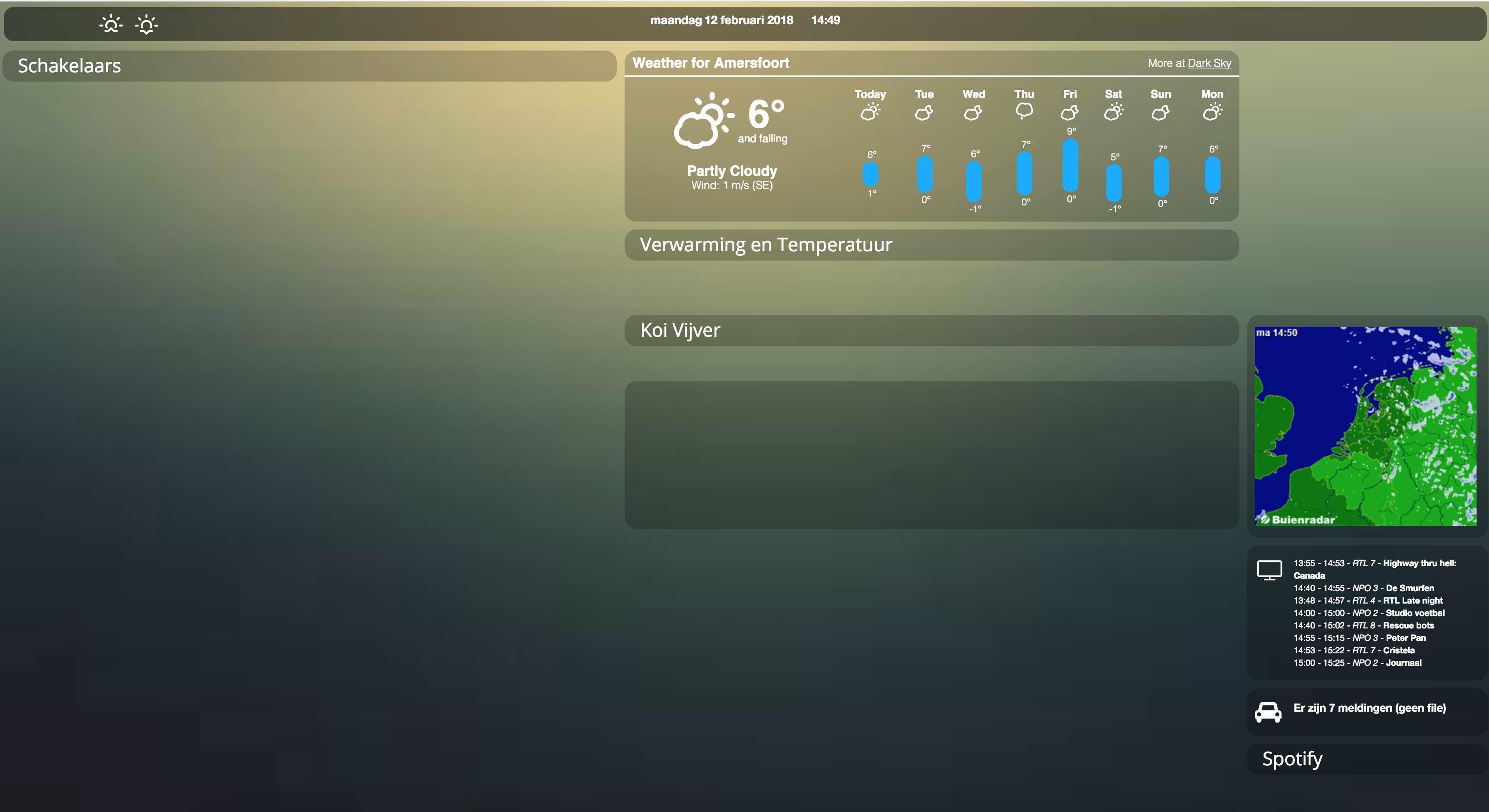

Post by michaelm86 »
Hi DewGew,
did i do anything wrong?
The switches and the ping devices aren't showing.
this is my screen:
this is my config:
config['garbage_maxitems'] = '7';

michaelm86 wrote: Monday 12 February 2018 14:51 Hi DewGew,
this is my screen:
this is my config:

Disable those:
config['auto_positioning'] = 1;
config['use_favorites'] = 1;
michaelm86
Posts: 28
Joined: Friday 02 February 2018 11:36
Domoticz version: 3.8153
Thanks, but that didn't do the trick..
I set both the values to '0'. still nothing to see :P
got some more suggestions?
