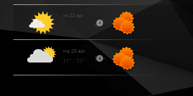

EdwinK wrote: Saturday 21 April 2018 21:23 Rob (or others)
Can something be done with this?
https://www.weeronline.nl/Europa/Nederl ... on/4057944
You mean this @EdwinK ? :D
maybe not the most beautiful way, but I used an iframe for it.
Just make a iframe, like:
frames.hooi = {refreshiframe:10000,height:230,frameurl:"//www.weeronline.nl/Go/ExternalWidgetsNew/TwoDaysCityPollen?gid=4057944&sizeType=1&temperatureScale=Celsius&defaultSettings=False",width:12}
Add frame to a block, like:
columns[2] = {}
columns[2]['blocks'] = [frames.hooi]
columns[2]['width'] = 5;
There you go, you got a "hooikoorst" layout, for 2 days ;)

EdwinK
Posts: 1820
Location: Rhoon
Re: Dashticz - Feature Requests
Post by EdwinK »
Yes, indeed. Something like that :) At least it's a beginning. Thanks.
