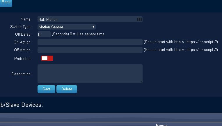

rrozema wrote: Monday 18 June 2018 14:51Yes, that is a workaround. And i do things like that. However, dzvents exposes all sorts of attributes for each device and yet none of these can be used to identify a switch from a motion sensor? I don't think that's the way it was intended.snellejellep wrote: Monday 18 June 2018 14:45 you can use a prefix in the name of the devices like lampxxx or PIRxxx that is what i use and then with a wildcard like PIR* you can cycle trough them
cant you set the switch type to motion sensor like the image above?

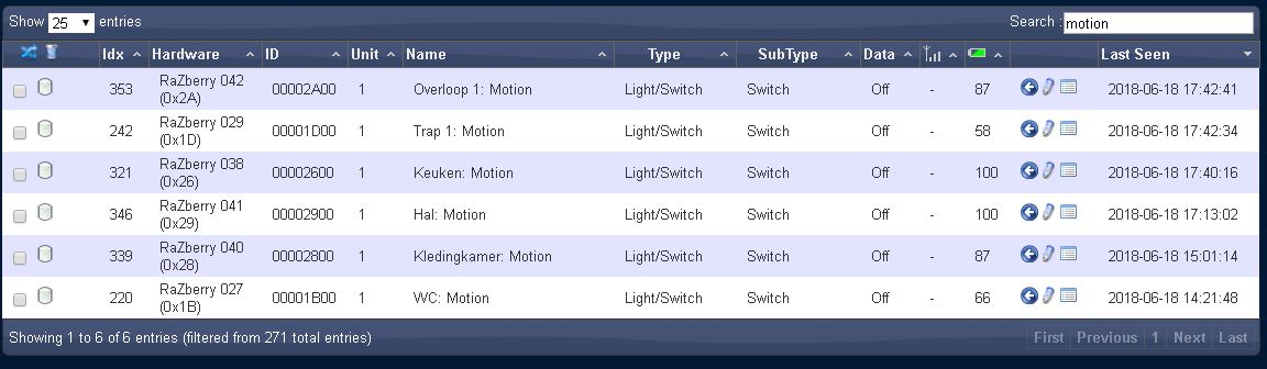

rrozema
- Posts: 470
- Joined: Thursday 26 October 2017 13:37
- Location: Delft
Re: DzVents: Make rooms available as device groups
I agree. It is probably not dzVents making these devices look all the same, that's why I said I am in need of some guidance here. To illustrate the problem, here's my device list filtered on devices that have 'motion' in their name:
As you can see my motion devices are all listed as 'Light/Switch' and SubType 'Switch'. I have yet to find how I can change these values. They automatically assigned when the device is first detected. In the properties in the Switches tab there is an option to select 'Switch Type:', which can be set to 'Motion Sensor', but that value can't be found in the properties dzVents exposes for the device:
Edit: Forum code can't make the attachments show up on the correct place. please see the attachments for the pictures.
- motion device switch properties.JPG (35.08 KiB) Viewed 3468 times
- motion devices.JPG (77.35 KiB) Viewed 3468 times
- waaren
- Posts: 6028
Sorry but still don't get what your problem is with the identification of these sensors in dzVents. I see the same as you do in the devices tab but dzVents is able to identify the switchtype property correctly.rrozema wrote: Monday 18 June 2018 18:01 I agree. It is probably not dzVents making these devices look all the same, that's why I said I am in need of some guidance here. To illustrate the problem, here's my device list filtered on devices that have 'motion' in their name:
The output of this dzVents code snippet
dz.devices().forEach(function(device)
if string.find(device.name,"otion") or string.find(device.name,"eging") then
print(" device ID: " .. device.idx .. " ===>>> " ..
device.name .." ===>>> type: " ..
tostring(device.switchType))
end)
2018-06-18 19:15:11.955 Status: dzVents: device ID: 30 ===>>> Trap bewegingsmelder ===>>> type: Motion Sensor
2018-06-18 19:15:11.956 Status: dzVents: device ID: 32 ===>>> WC bewegingsmelder ===>>> type: Motion Sensor
2018-06-18 19:15:12.074 Status: dzVents: device ID: 500 ===>>> Beweging buiten ===>>> type: Motion Sensor
2018-06-18 19:15:12.077 Status: dzVents: device ID: 508 ===>>> Homewizard - Beweging buiten ===>>> type: Motion Sensor
2018-06-18 19:15:12.101 Status: dzVents: device ID: 582 ===>>> XMotion-1 ===>>> type: Motion Sensor
2018-06-18 19:15:12.102 Status: dzVents: device ID: 583 ===>>> XMotion-2 ===>>> type: Motion Sensor
2018-06-18 19:15:12.114 Status: dzVents: device ID: 657 ===>>> XMotion-3 ===>>> type: Motion Sensor
2018-06-18 19:15:12.116 Status: dzVents: device ID: 670 ===>>> Beweging kantoor ===>>> type: Motion Sensor
2018-06-18 19:15:12.146 Status: dzVents: device ID: 794 ===>>> X-Motion zolderhok lux ===>>> type: On/Off // combined Motion sensor / lux device
2018-06-18 19:15:12.147 Status: dzVents: device ID: 795 ===>>> XMotion Zolderhok ===>>> type: Motion Sensor
2018-06-18 19:15:12.148 Status: dzVents: device ID: 796 ===>>> X-Motion6 lux ===>>> type: On/Off // combined Motion sensor / lux device
2018-06-18 19:15:12.149 Status: dzVents: device ID: 797 ===>>> XMotion-6 ===>>> type: Motion Sensor
rrozema
- Posts: 470
- Location: Delft
Thank you. I don't know how I missed this. You are absolutely right, device.switchType will do the trick.waaren wrote: Monday 18 June 2018 19:18Code: Select all
