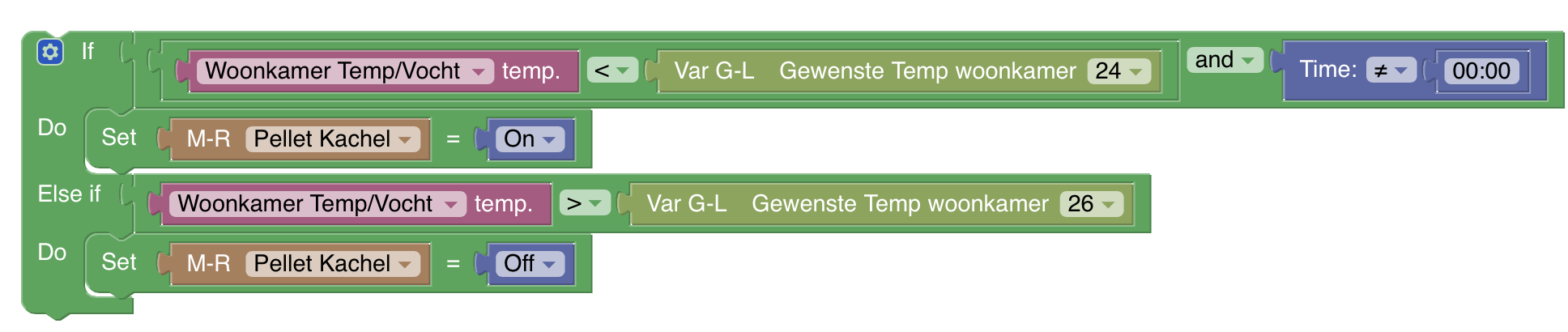

I'm currently use a temp/humidity sensor "Philio Technology Corporation PH-PAT02-B.eu Multisensor 2in1+"
When I add this sensor in Domotics, I can read the temperature 22,0 and humidity 65%.
Now I want to switch "on" my pellet stove when temperature is below 24 degrees Celsius.
I tried this with "Blockly" but this is not working.
What do I wrong?
Can someone help me with this!

have you set device as trigger?
something like this should work.

IF cannot be only a temperature. I always add a time, like "IF TIME is not 00:00"

Hi, I tried the example that you show me, but it doesn't work?
But...how to set the device as trigger?
Do you have an example for me!

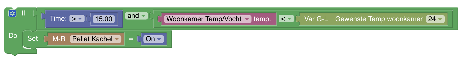

Schermafbeelding 2018-05-27 om 23.47.36.png (68.94 KiB) Viewed 3530 times
I also tried to add a time, it doesn't work.

You’re using the If/Else If block, try the one without the blue square in the left upper corner.

Hi, thanks a lot, it works now.
